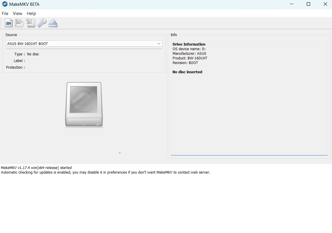

And seeing my drive manufactured in 2015, I decided to take my chances. And of course, it failed, really bad:
Screenshot 2023-06-01 235826.png (46.97 KiB) Viewed 6425 times
The drive firmware version has now become "BOOT". It turns on, blinks twice, repeatedly, and does nothing else.
>makemkvcon64.exe f -l
Found 1 drives(s)
00: \Device\CdRom0, \Device\CdRom0, D:
  ASUS_BW-16D1HT_BOOT
MakeMKV still recognizes it, but refuses to update the firmware.
