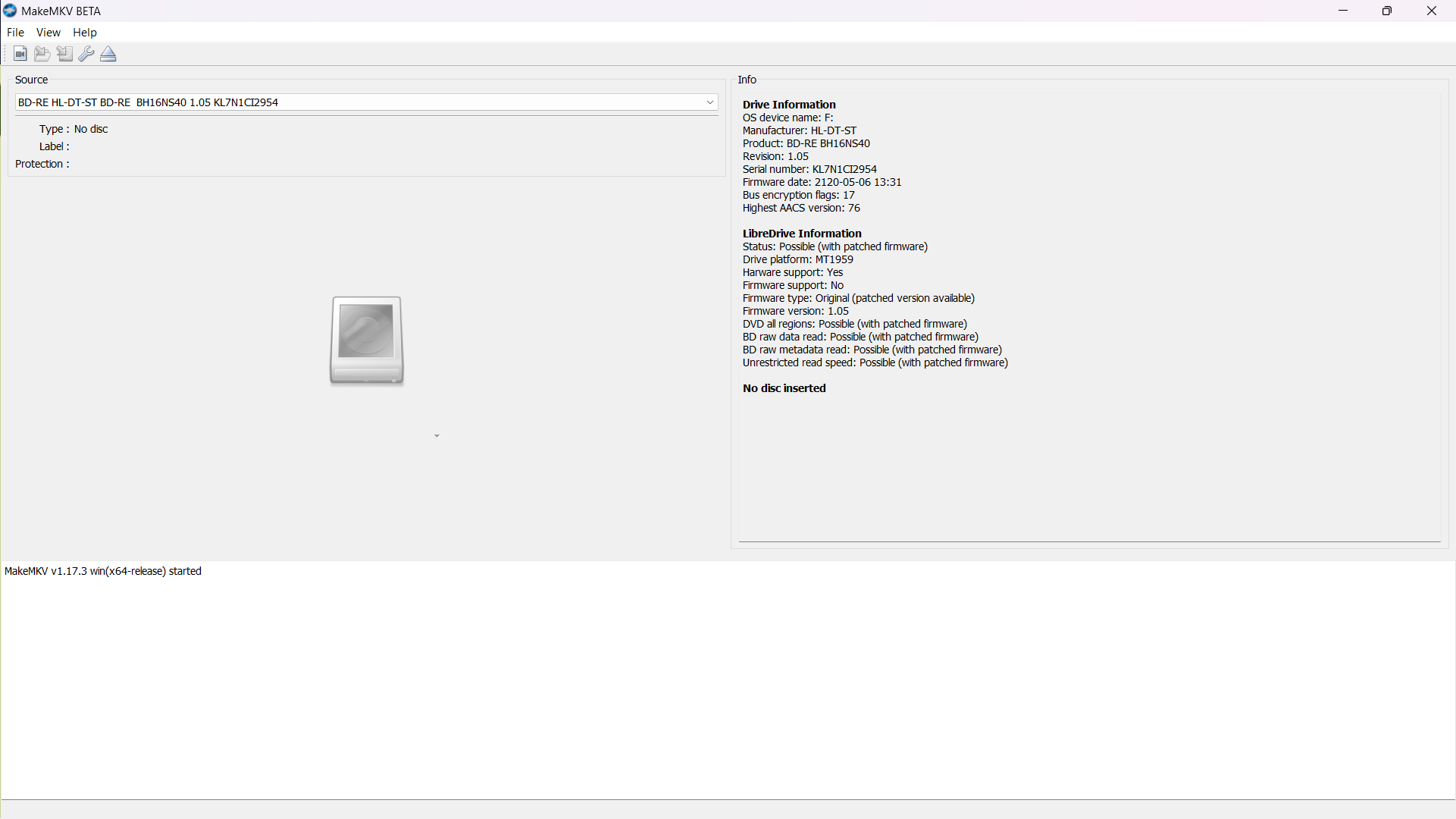

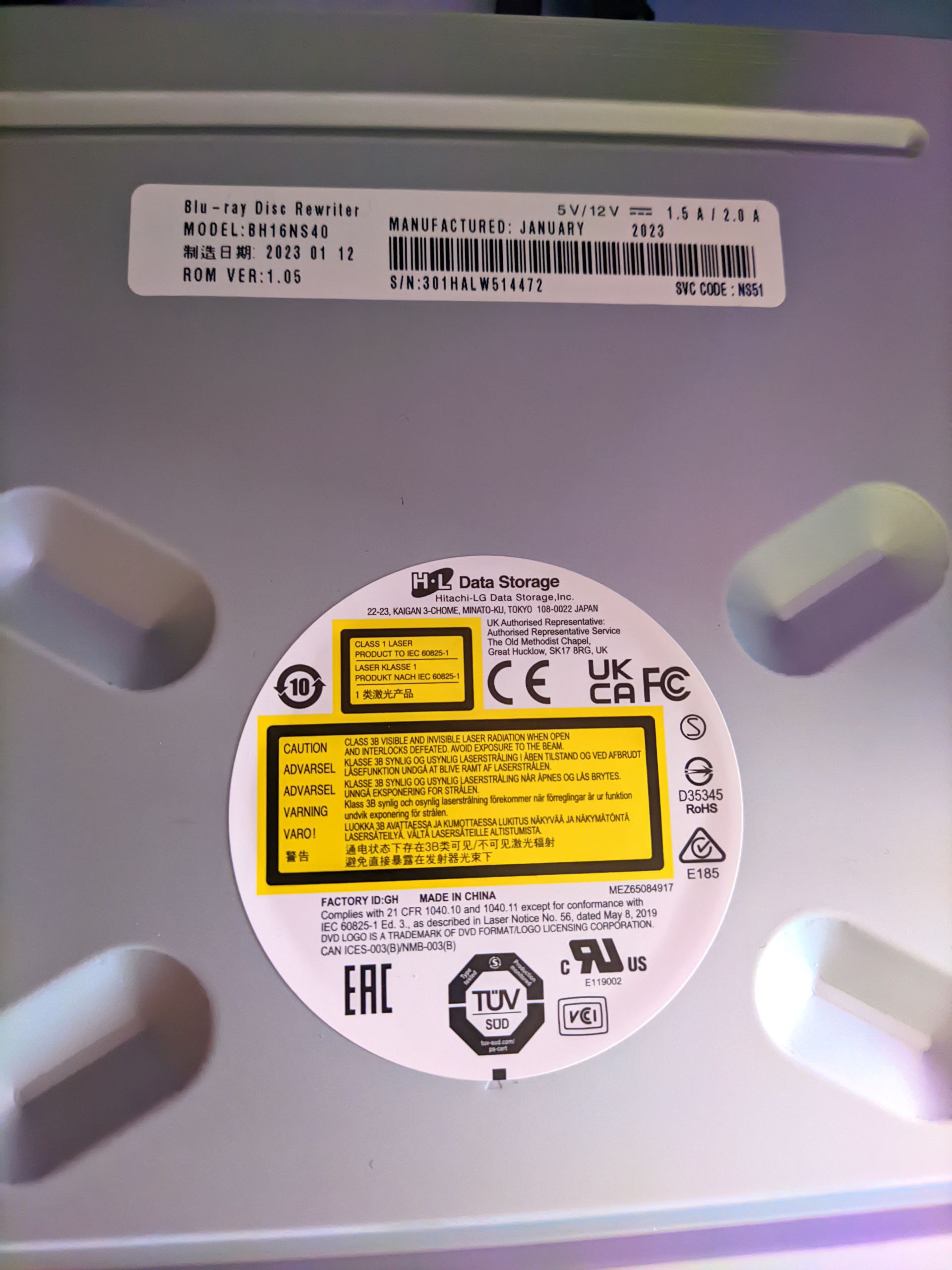

I recently bought an hitachi-lg BH16NS40 and even though on the site it says that this drive can read BDXL up to 128GB, if i put a 4k disk in it, it won't show up.
1. Do i have to flash a firmware?
2. Do i have to return the drive and buy another one? (i was looking an asus BW-16D1H)
I leave attached a photo of the drive and a screenshot of what makemkv says.
Screenshot 2023-05-03 155554.png (68.41 KiB) Viewed 230586 times

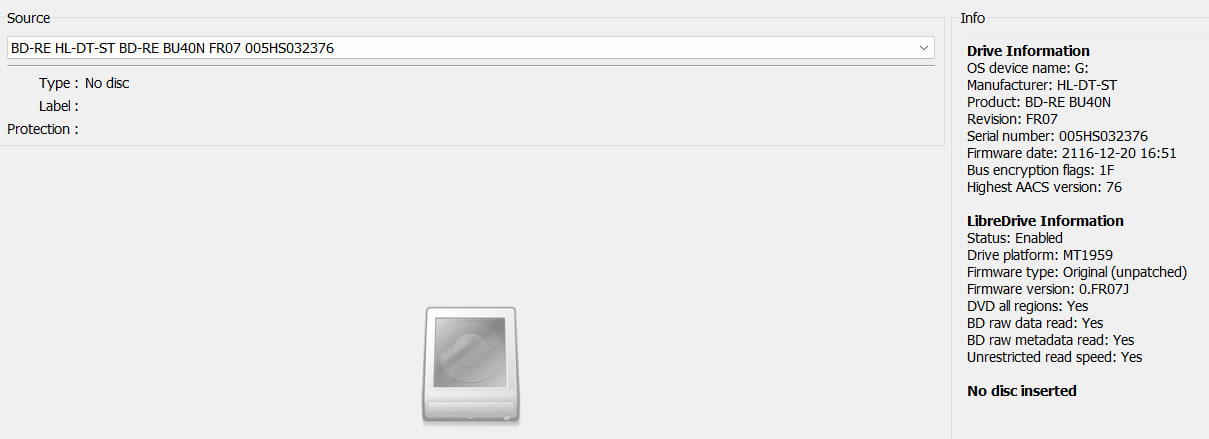

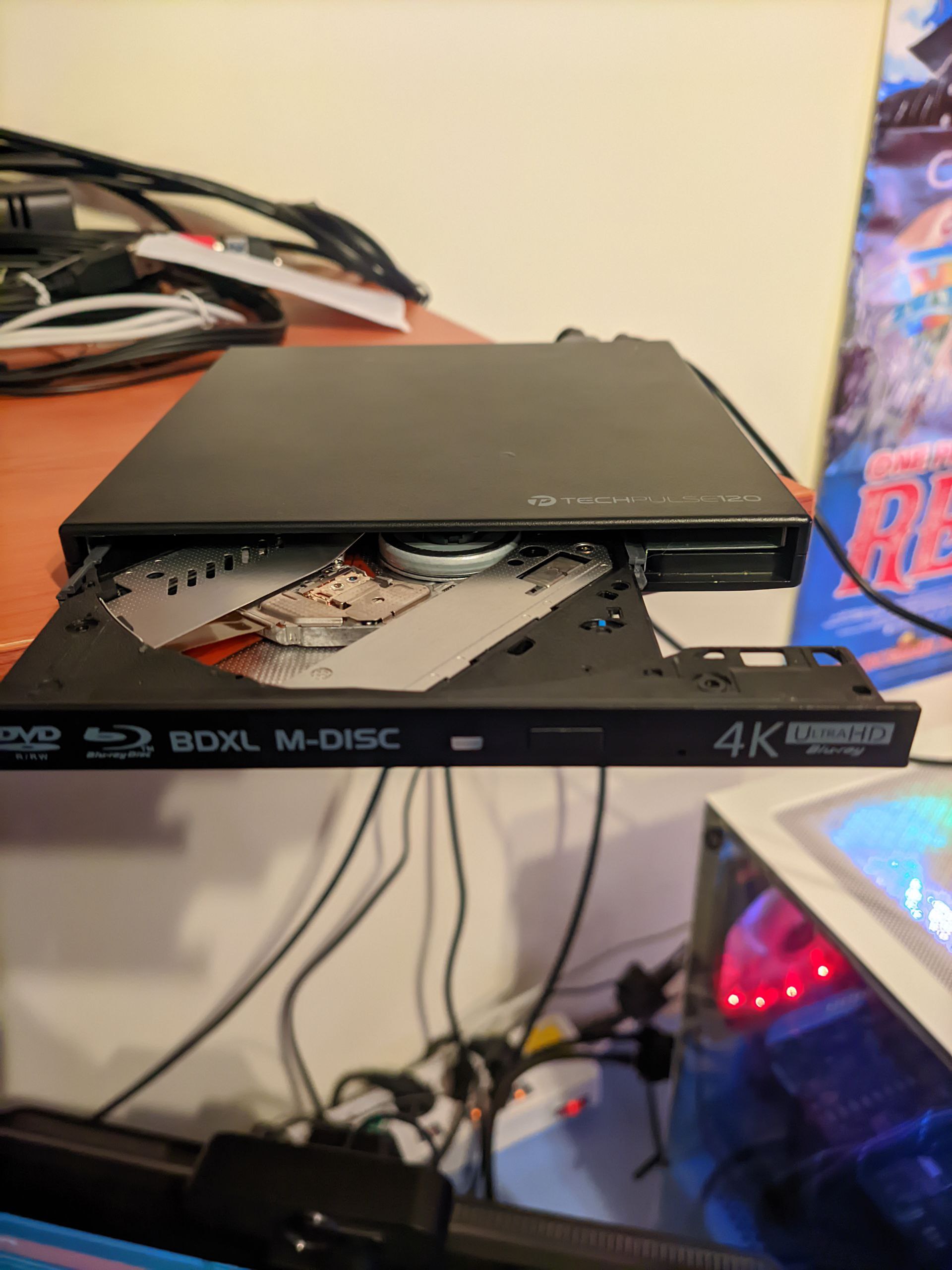

I also have an hitachi-lg BU40N, but i wanted to change it because i didn't like the form factor, and kinda slower rip times.
anyway this drive can easily read 4k drives and it isn't even patched
Here's a screenshot:
Screenshot 2023-05-03 162732.png (60.55 KiB) Viewed 230578 times
Generally speaking, LG & ASUS drives require flashing to rip UHDs. Check out the Ultimate UHD Drives Flashing Guide

ye i know, but i have another drive also hitachi-lg BU40N, that can read and rip 4ks even without flashing a new firmware, and it rips faster the 4ks than the new BH16NS40, and it's a slim form factor, which by any means, slims are slower. So this let me think that my BH16NS40 it's not really capable of reading 4k, and i should change.
here's a screenshot of the BU40N

Your assumptions aren't quite accurate. Technically yes, the max speed for the BU40N is 6x for UHD and 8x for the NS40 but you will generally get that 6x speed from the BU40N for most of the rip, whereas the NS40 may reach 8x for some moments of a rip but for a lot of the rip it will only read at 5x-6x. Therefore, in the end, the BU40N is usually the quicker drive to complete a rip.

this is a known thing a BU40N is faster than a stock or flashed BH16NS40 if you flash it to a WH16NS60 it will be slightly faster than a BU40N

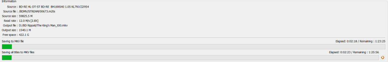

nono my BH16NS40 stays at 3.0x the entire time it rips a 4k disk
and while doing it making a "not so happy noise" (i leave attached a video, put the volume to max to hear it)
i found the firmware for my drive here viewtopic.php?f=19&t=19113
here's a photo of the speed
here's a link of a video that i made of the drive making noises: https://youtube.com/shorts/coNHo2arBYU

well 1 you didnt follow the guide
2 could be bad drive disc or fw
try changing to recommended fw first see guide below

You put the absolute worst firmware available on the drive, so that won’t help. For the best chance at some decent speeds, flash WH16NS60 1.02-MK firmware to it. That may also help with the noises.
