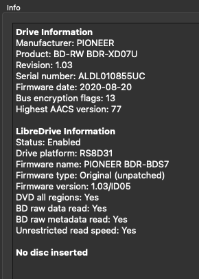

Billy, OK so I guess I have 1.03.
So can you clarify what this means for me? What exactly am I missing then?
edit: I have been successful in ripping so I guess my question really is what am I missing what the firmware would do? Kill the ability to rip?
-matt.
-matt.
- MakeMKV info
- Screen Shot 2023-04-28 at 7.00.39 AM.png (36.71 KiB) Viewed 25010 times

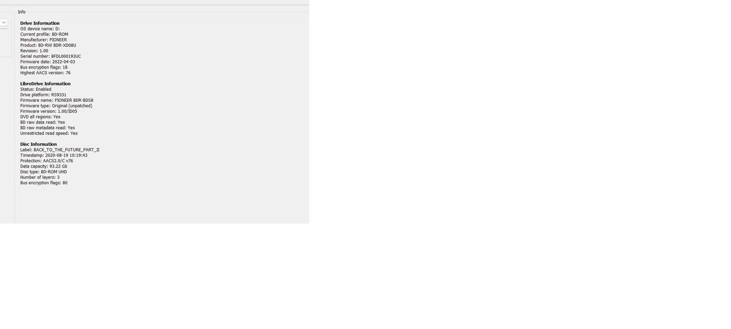

I picked up a BDR-XD08U with f/w 1.00 which thus far as been able to rip two of the discs I have been having issues with.
- p.jpg (49.04 KiB) Viewed 24832 times
