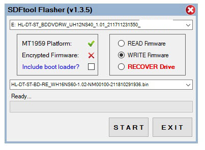

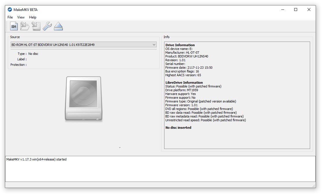

I have seen a couple threads where people got this drive able to rip 4k discs. I'm super confused by this process. I downloaded the bh14ns40 patch tool exe from this thread
viewtopic.php?t=19780
and used the included firmware bin file. It gave me the error at the end. Makemkv reports same data as before. pic below
I ran the SDtoolflasher (v1.3.5) but the only firmware in the "all you need fw pack" only had the WH16NS60 fw in it. Pic below. Should I use this?
Or should I use the cmd prompt instead as the YT video demos?

- Posts: 5803
Re: UH12NS40
it will probably work on wh16ns60 fw let us know and i'll update the guideJohnqmalapert wrote: ↑Sun Mar 12, 2023 2:13 amI have seen a couple threads where people got this drive able to rip 4k discs. I'm super confused by this process. I downloaded the bh14ns40 patch tool exe from this thread

Re: UH12NS40
no harm if it doesn't work?
- Posts: 5803
Re: UH12NS40
could die but not likely as its mt1959

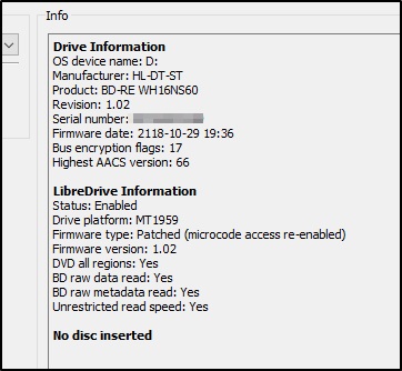

Re: UH12NS40
Ok, seems to have worked (i think), pic below.
1st disk ripped successfully, while the 2nd/3rd have reported read errors. They seem to be hardware related. Does it seem that way to you? I've been using the backup option.

- Posts: 5803
Re: UH12NS40
Yeah you can try cleaning the discs other than that cleaning or replacing the drive
But I will add that drive to the guide
