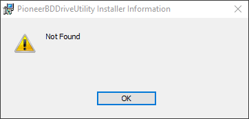

I just added a Pioneer BDR-S13U-X to my setup for UHD disc ripping. It's an internal drive on the very first SATA connection for my motherboard. MakeMKV and Windows both recognize it and use it no issue.
I wanted to install Pioneer's BD Drive Utility so I could switch the drive into "performance mode" or whatever Pioneer calls it, so that it will rip my discs as quickly as possible with no concern about how loud it gets. But when I downloaded the correct utility direct from Pioneer's website and went to install it, it says it's extracting a .msi file, and then gives a vague error that simply says "Not found" and then closes saying it didn't install anything.
Going into my user's Appdata folders, I'm able to locate the .msi file it extracted, and running it gives the exact same error. I've also tried running the install with Administrator privileges, no dice. It simply refuses to install.
This is a BRAND NEW installation of Windows 10, from a USB drive made with Microsoft's official Media Creation Tool. Windows 10 22H2, OS Build 19045.2673 for anyone interested.

Screenshot of the error message when trying to install the Pioneer Drive Utility.

You need to install the Visual C++ Redistributable Packages for Visual Studio 2013. They have x86 and 64bit versions, I installed both just in case. I found out about this after having your exact same issue. Tried the last version and got the "not found" message. Then I tried an older Japanese version and I got a message telling that the Visual C++ package was needed. I got the files from MS, vcredist_x64.exe and vcredist_x86.exe , installed them an then tried again the last version of the Pioneer Drive utility. It completed the install and worked. My drive is a brand new BDR-S13UBK with FW 1.04.
When you get the "Npt Found" message is NOT because the drive is not found, it is referring to the missing software package and it has no relation to FW version.
In my case that was not the issue, I had everything installed, even went through a mass installer for all packages to make sure in case there was a corruption with one of the packages.
There seems to be some sort of communication issue with the motherboards or perhaps something in Windows in my case, but I did a fresh Windows install and still saw issues, and tried the drive on two different motherboards.
