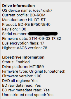

by scarpogre
Screen Shot 2022-12-03 at 12.21.36 PM.png (41.46 KiB) Viewed 43999 times
It worked!
Thanks again for helping me restore my drive.

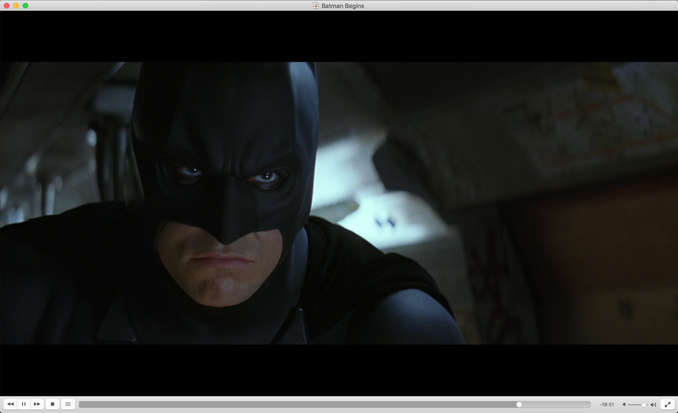

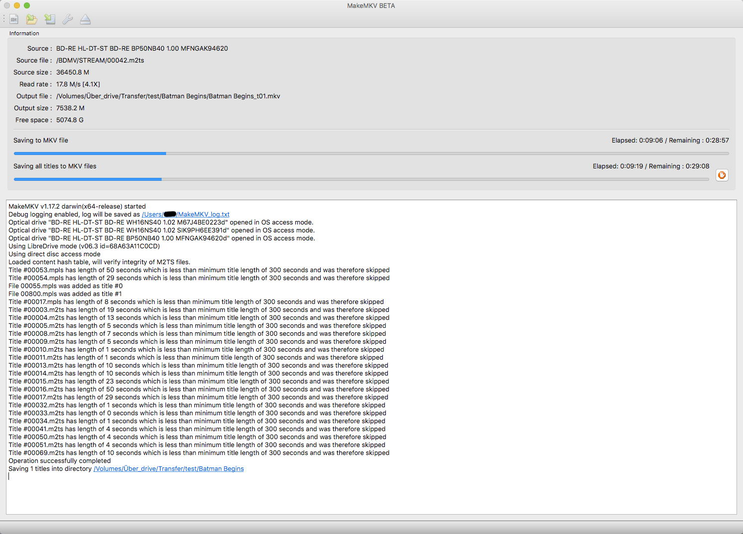

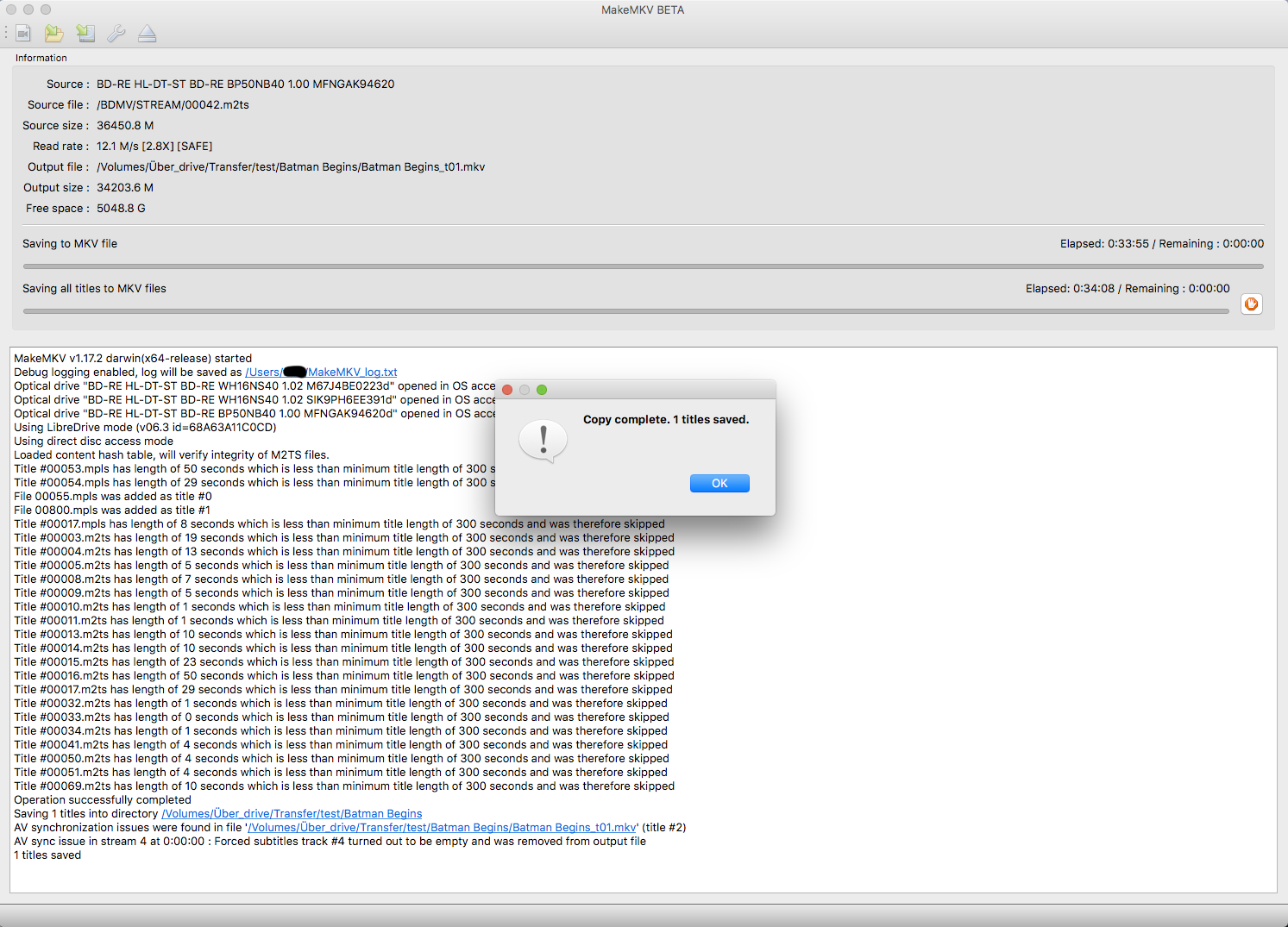

by scarpogre
To test the drive, I ripped Batman Begins (BluRay) for a test and it is working OK.
Thanks again for the help
