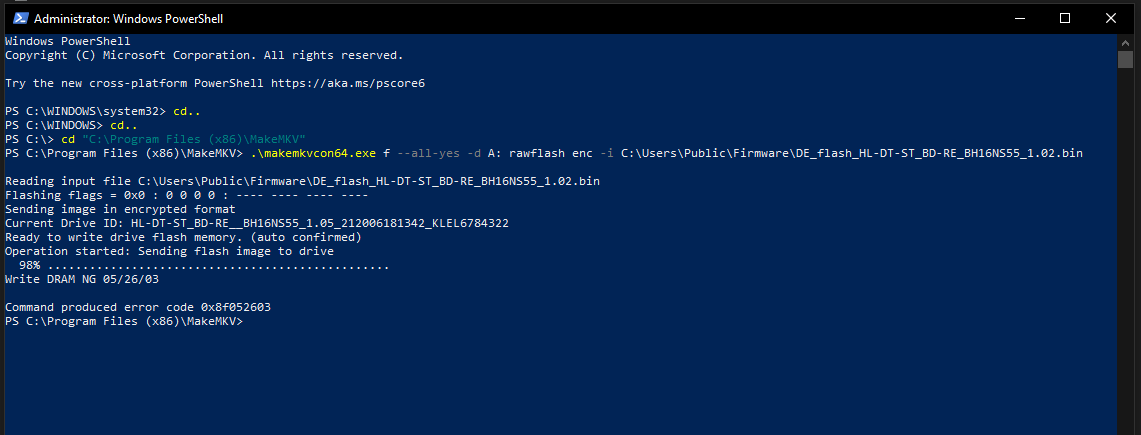

Then, using the Power Shell Admin commands like in the "Ultra HAX0R V2" Video I tried flashing the drive and this lovely error popped up:
bd flash help 2.PNG (27.91 KiB) Viewed 6422 times

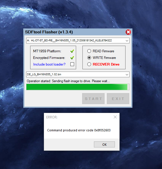

After that I read a few more forum Posts and discovered the SDFtool Flasher by MartyMcNuts. I tried using the Tool but i got the same exact error
bd flash help.PNG (300.08 KiB) Viewed 6422 times

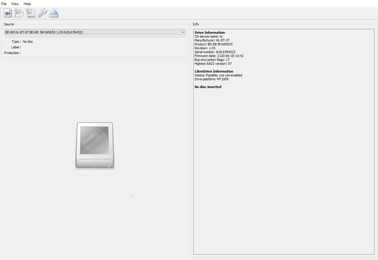

PS: These are the Specs of the drive
bd flash help 3.PNG (40.14 KiB) Viewed 6422 times
Am I missing something? Please help. Thank you so much in advance!

Your problem was you wer trying to flash to NS55 1.02 directly. You cannot do this from an encrypted firmware. As stated in many places (including Billy's guide) when you have encrypted firmware, flash to NS60 1.02-MK, then you can flash to another firmware if you want to.
