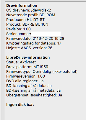

Hi there,
I'm having some problems with my BU40N drive. I'm not very good at things like this. I've been reading all the pages on flashing the BU40N drive etc. So I'm not lazy. I just don't understand it. Could any of you read my drive settings/info and tell me if it looks right or not? Would really appreciate it!
I've attached a screenshot of the drive info.
Skærmbillede 2022-10-16 kl. 22.20.25.png (50.86 KiB) Viewed 6945 times
