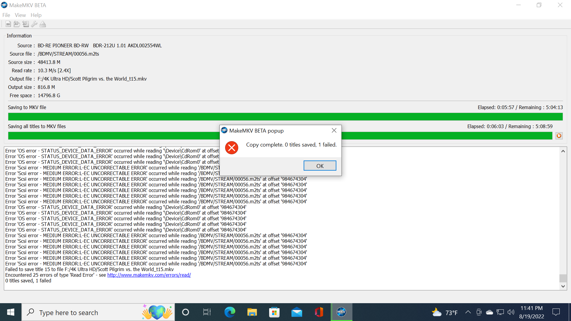

I just got this new drive from B&H, and it failed to rip a 4K disc. This disc is also brand new and clean.
It reads the disc quickly without any issues but fails to rip. I ripped 2 other 4k discs before this one without any issues.
I ripped this disc before without any issues with my LG WH16NS60. However, my LG WH16NS60 is dead now.
Is there anything I can do before I return this brand-new drive?

clean the disc with a very soft lint free microfiber cloth and some water then dry with another.leosantare wrote: ↑Sat Aug 20, 2022 4:36 amI just got this new drive from B&H, and it failed to rip a 4K disc. This disc is also brand new and clean.

I did clean the disc as you suggested twice, and still no luck. Is there anything else I can try other than buying another brand-new copy?

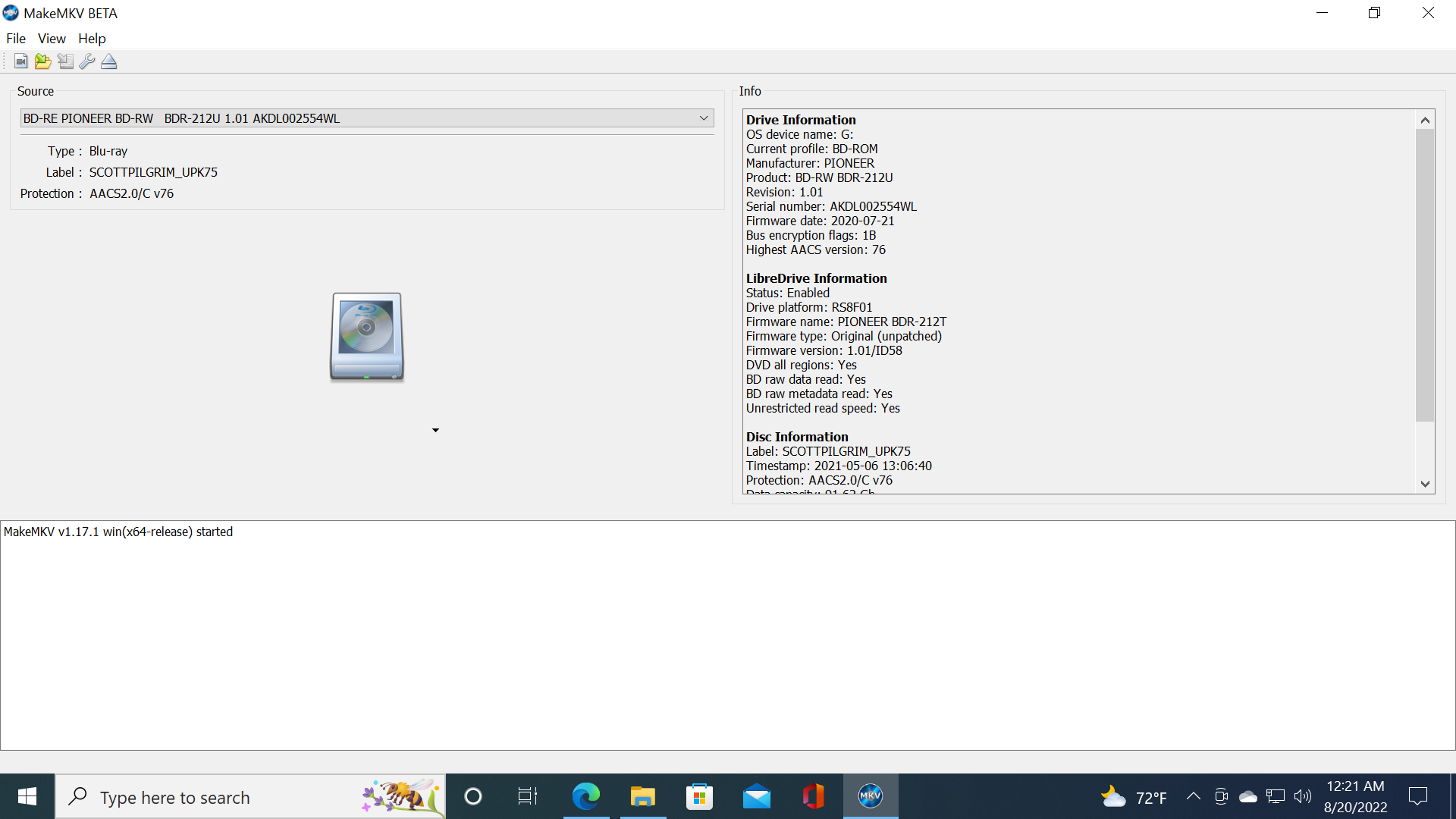

Update to 1.02 firmware. It might help. But chances are not high.

Well, I was able to rip all my 4k's, (33 titles) with the bdr-212ubk no problem. Except for the Scott Pilgrim 4k and I cleaned it 5 times. It seems strange to me that I was able to rip this disc fine with my LG before it died.
Does the Scott Pilgrim 4k have a reputation of being problematic? In the meantime, I just ordered another brand new copy of this disc.

Don't know about that particular title but it is not that uncommon for a UHD disc to be faulty and require replacing.leosantare wrote: ↑Mon Aug 29, 2022 1:55 amIn case I wasn't clear, I had to format my drive and re-rip all my discs again.

I got another copy of the 4k title, and it ripped without any issues. Therefore, I have ripped (40) 4k discs on the BDR-212 without any issues. The drive is very quiet.
