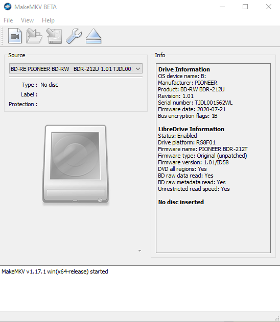

For reference, I've attached my drive's info from MakeMKV.

Pioneer drives do not require updated firmware. Your status screen point this out. It's only the non-Pioneer drives that need changes, if you're trying to access UHD disks.
