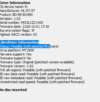

I just bought a brand new Archgon MD-8107S-U3YC-UHD which i've been told is just a LG BU40N in an external shell
So I followed this tutorial
https://www.youtube.com/watch?v=ne3SchK ... =19&t=215s
and keep getting the same error.
Am I screwed or is there a step I'm missing?
Checksum error when trying to flash
- Drive Type
- drive type.PNG (13.47 KiB) Viewed 4365 times

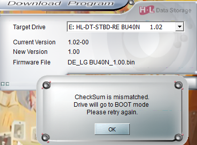

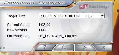

- Firmware I Used
- flash type.PNG (106.19 KiB) Viewed 4365 times
- Error Message
- fail.PNG (147.95 KiB) Viewed 4365 times

Re: Checksum error when trying to flash
The video was out of date when it was released
Follow the real guide
Or get an automated flash from me or marty

They got that error because they didn't follow the guide and use a new flasher they use the old flasher that will never be able to encrypted firmware
