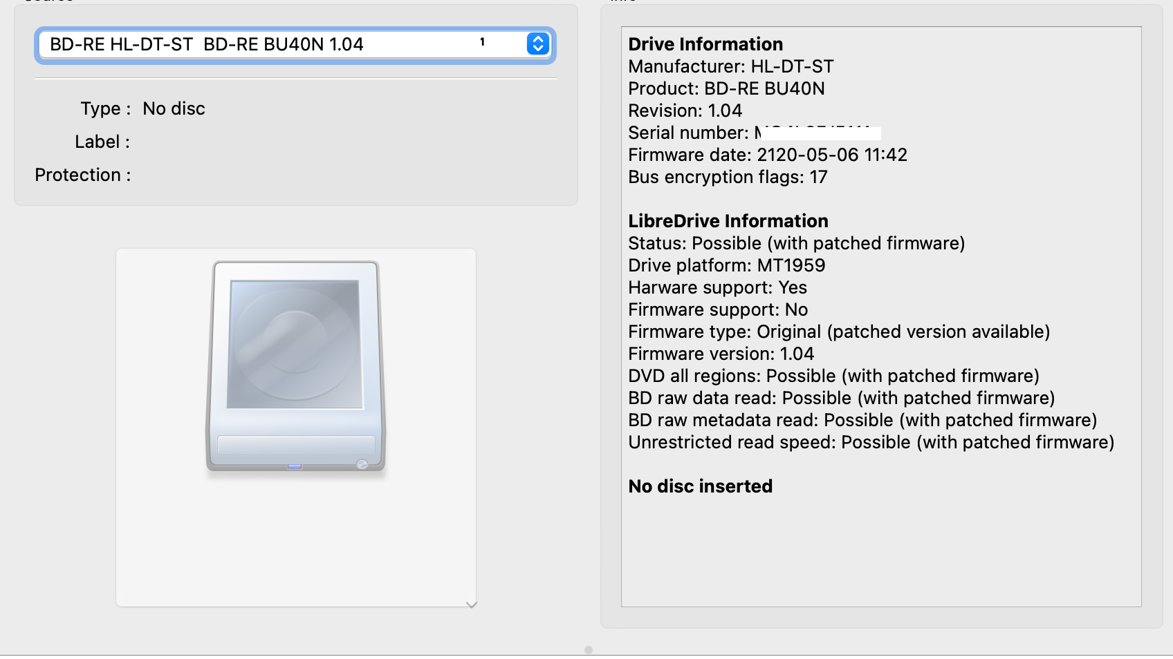

So, I decided to give it a go and flash my own drive. You can see the drive (which is attached via USB enclosure) on the attached screen shots.
I'm on macOS (M1 chip) but have access to a Windows 10 PC and plan to use this viewtopic.php?f=16&t=22896
I'm totally committed and know I can brick my drive so:
1. Can you guys/girls point me to the correct firmware to flash it with?
2. Anything I should be aware of before I go?
Posts: 4500
Re: Flash a BD-RE BU40N drive - first time
Flash the 1.04 from BU40N-Main in the firmware pack.

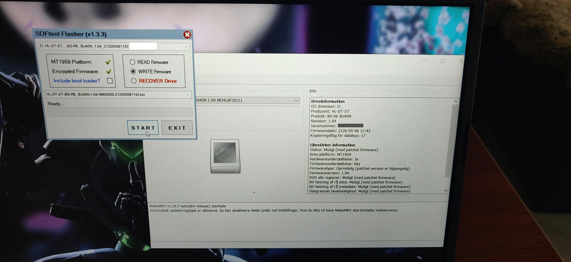

Got this far and everything looks as it is supposed to but nothing happens when I press "Start"
Any ideas?
Posts: 5714
outland wrote:
Mon Jun 06, 2022 7:19 am
Any ideas?
try closing makemkv
if still no just use the command line from my guide
