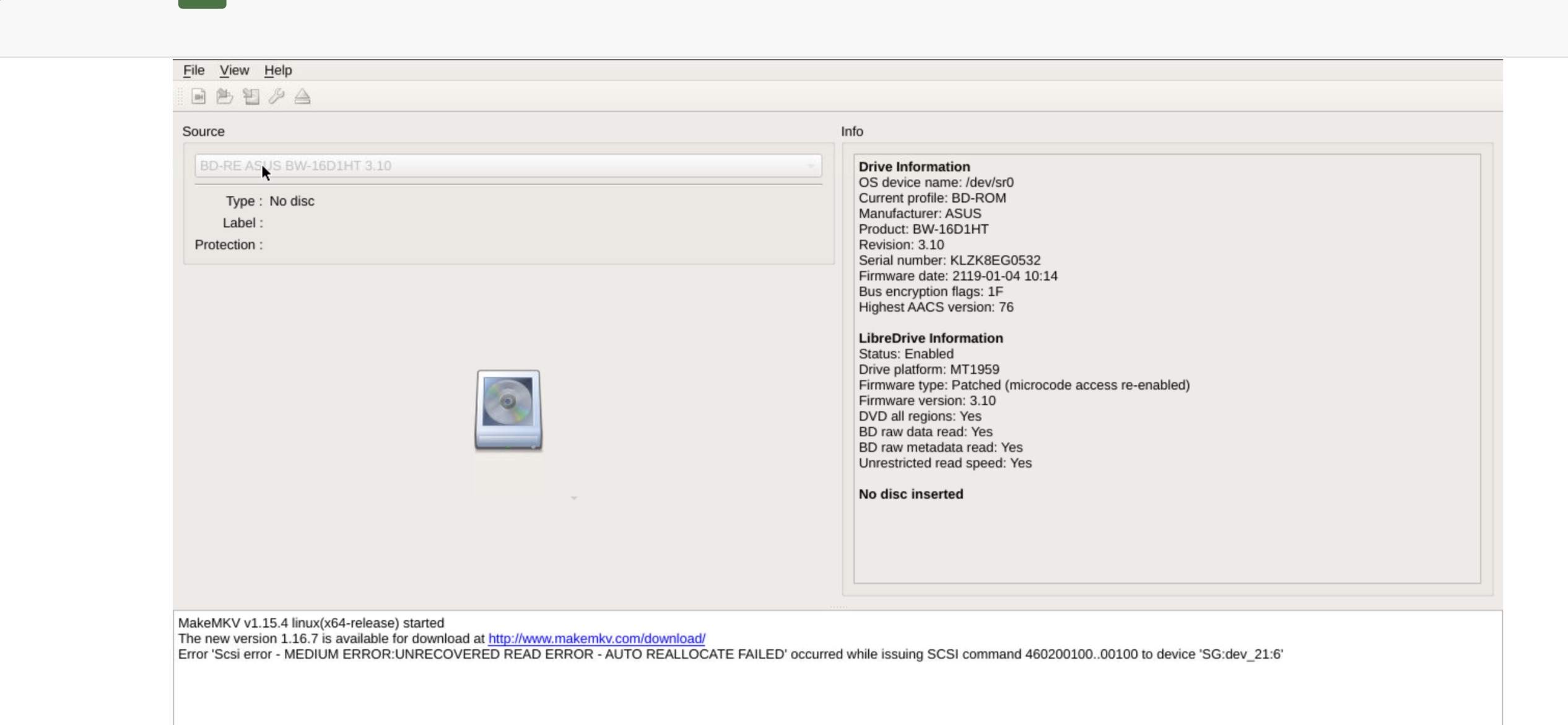

somehow it seems that my Asus BW-16D1HT died. I used to run it in my Unraid Server but a while ago it stopped reading discs, see screenshot.
And when connected to my MacBook with my Unitek Y-1099NEW, the drive is not recognized at all. No matter what I try. Very cumbersome.

bu40n is a tank. AFAIK there aren't any firmware versions that can't be flashed. I recommend flashing it back to 1.00 firmware if you get one. I've had zero problems with this little drive.
Recently some of us have begun using Pioneer drives, as well. I have the BDR-212UBK, as an example. It's slower than the BU40N but it reads just as well so far in my testing. So you have options.
