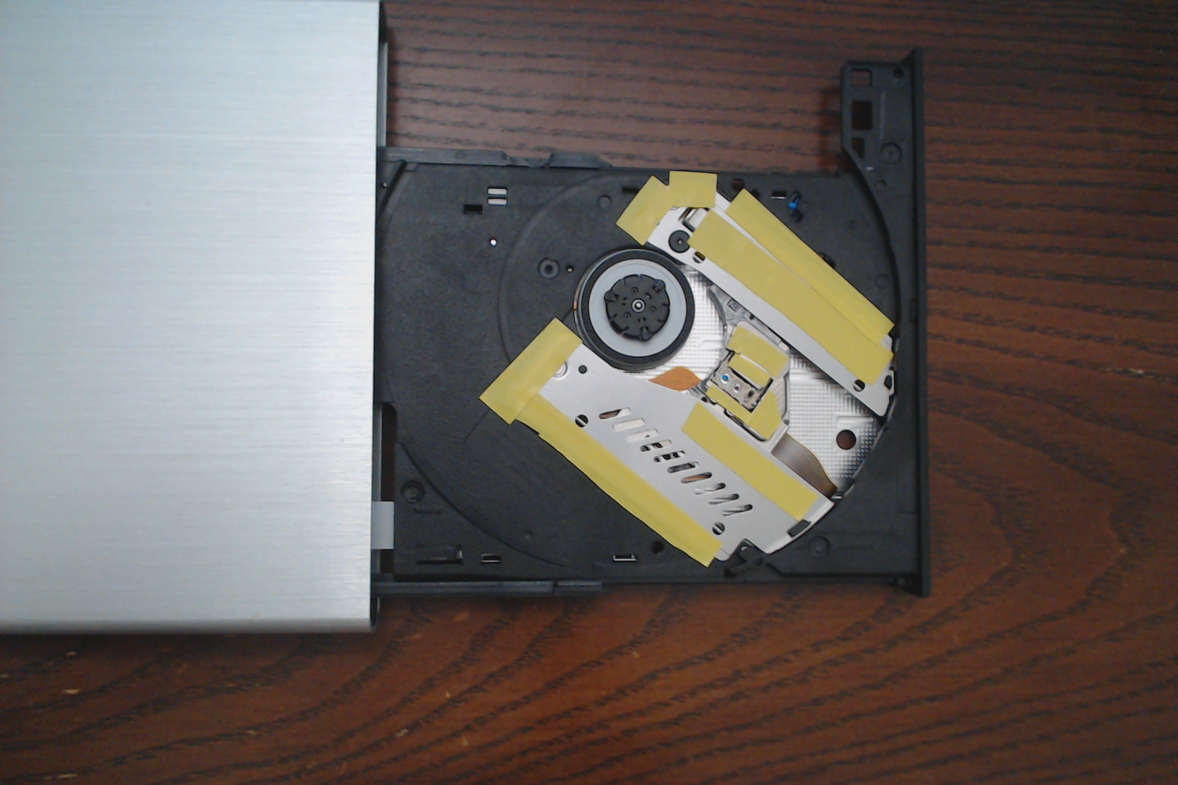

I've got the same Archgon drive, and it's coastered a couple of my discs. It's a thin scratch, but since it follows the data path, the errors it produces are uncorrectable.
Doesn't happen with every disc, but it seems to happen when the drive gets bumped.
I've sort-of fixed it by cutting out strips of vinyl tape and putting it along all the metal edges on the tray, including some on the head itself.
Picture 2022-03-11 21-31-01.png (3.67 MiB) Viewed 14195 times
