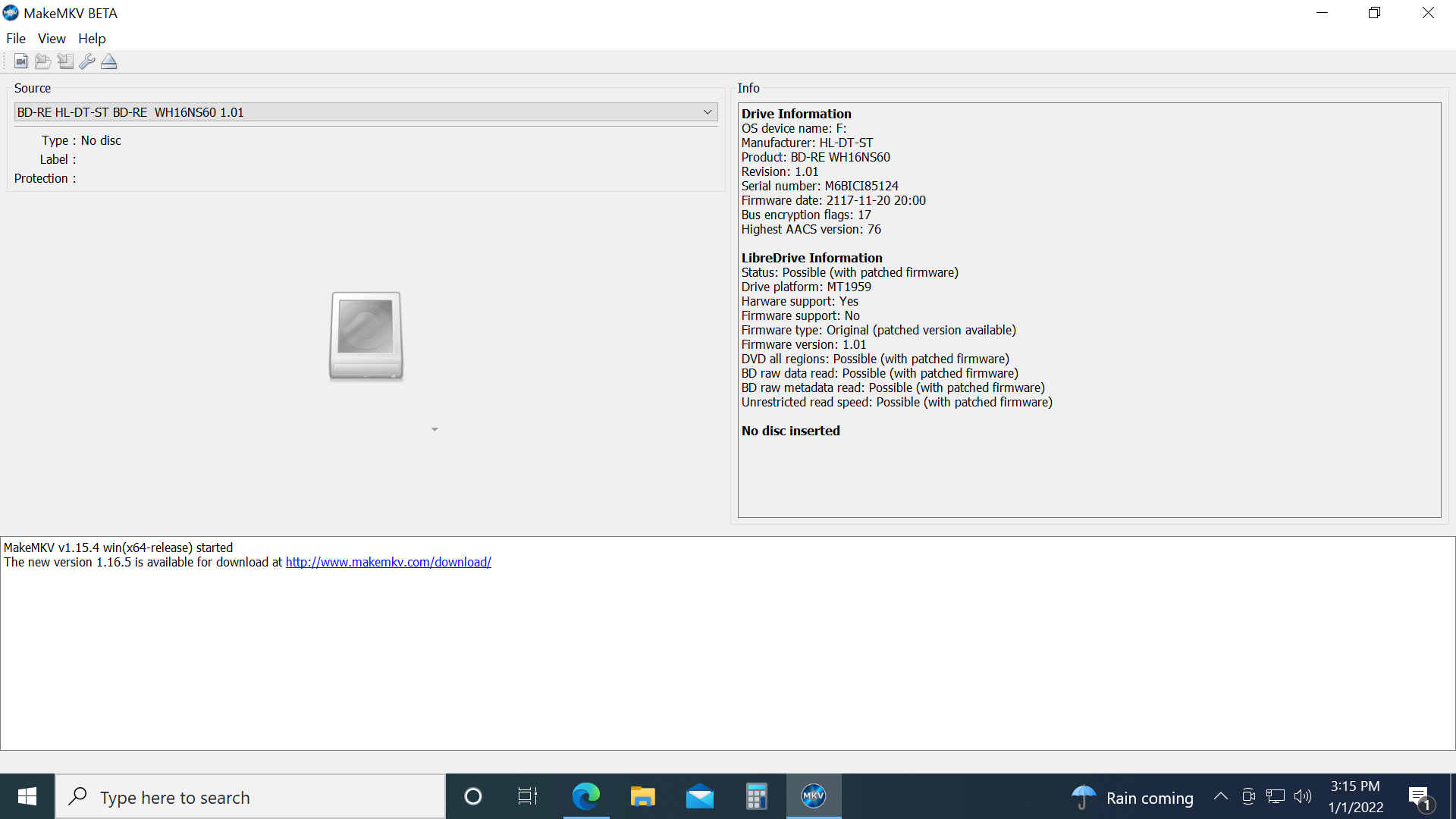

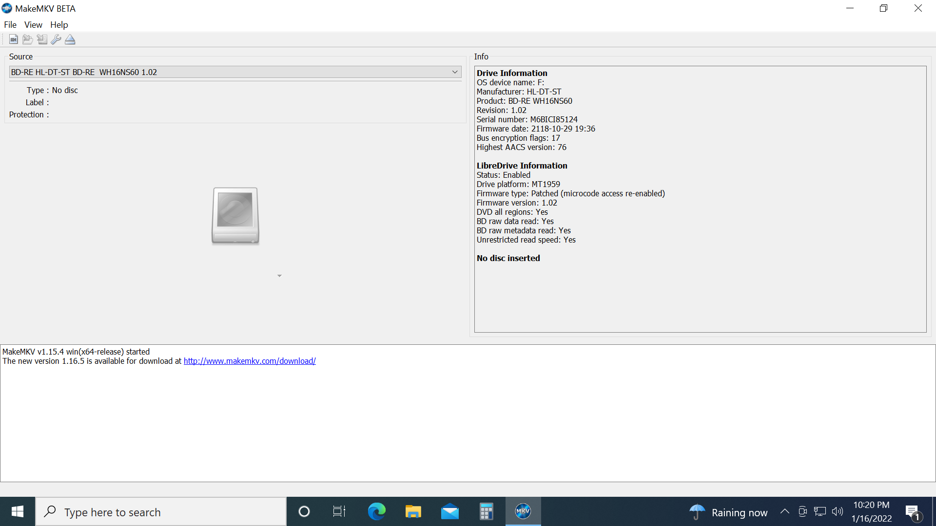

Currently, LG offers official firmware versions 1.01 and 1.03 for these drives. However, both of these will not work for ripping UHD discs.
Will the older firmware versions, (before 1.01) that LG released work for ripping UHD discs?
I used Billy's flasher, version 1.0 and the SDFtool flasher, version 1.02 which do work for ripping UHD discs. Are these versions personally made or were they officially released from LG at some point?
Can someone please explain this to me, are there any other versions?
Below are images of versions 1.01, 1.00 and 1.02 in makeMKV.

- 1.02.png (128.92 KiB) Viewed 17340 times
- 1.01.png (133.71 KiB) Viewed 17340 times
- 1.00.png (128.33 KiB) Viewed 17340 times

yeah 1.0 is lgs original I changed 1 byte to de to enable downgradesleosantare wrote: ↑Sun Jan 23, 2022 6:18 amHello,
What is the firmware history for the LG WH16NS60?
Thanks,
lgs original is 1.0 1.01 1.02 1.03
my de is 1.00
mike made the mk versions is 1.01 1.02 1.03
the only versions for ripping uhd are the de's and mk's
