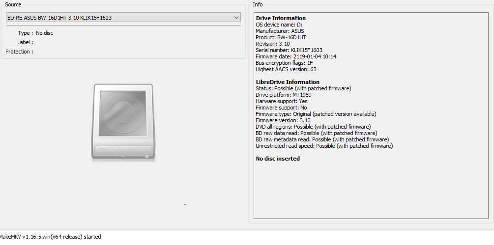

by derotam
So I am going to say that it MAY have been a bad SATA cable... After successfully flashing the drive via a USB converter, I opened up MakeMKV and it read the drive and had the correct updated drive info. I then shut down the computer and reattached via the SATA cable. Drive did not populate in windows so I tried moving it back to the original port 5 that it had been on in the beginning, no joy. Decided to change the SATA cable and viola it was recognized again and I am running my first copy on a BD disk now. It is so much faster...no more multi hour copies!
