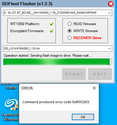

No luck. I was able to DL the unlocked asus flasher, which had the "WH16NS60 1.00." However when I used the SDFTool I got an error. - See attached
FYI before I performed this task I did change to "IDE" from "AHCI" of my SATA Controller just in case. Wasn't sure on that one.
Not sure what I did wrong here. I read and re-read everything, sorry.

Use another SATA port. E.g. SATA ports on an additional Marvell chips tend to fail. Use one that is connected to the motherboard chipset.unkis17 wrote: ↑Mon Nov 15, 2021 4:40 pm@BillCar,

In your case you must first flash to WH16NS60 1.02mk with enc checked the with that flasher you have. Follow the rest of the steps after that remember you must use the LG or Asus flasher as they flash the full firmware and bootloader sdf tool does not only use that to get off encrypted firmwareunkis17 wrote: ↑Mon Nov 15, 2021 4:40 pm@BillCar,

Re: WH14NS40 - LG Firmware bricked?
Thank you for the clarification about the 1.02MK firmware.
Earlier today I tried changing the SATA port and changing all SATA Controller (I have 2 on this PC it seems) to IDE as previously suggested. Well... This caused my whole system to crash even after trying to change it back.
A few hrs later I have Win10 reinstalled and working again. I was due for a clean install anyway, just didn't know I was doing it today...
Before I change things again. I have my SATA controller on AHCI and SATA 4/5 AHCI. Do I need to change this to IDE as suggested in the YT video to downgrade and flash in Win10PE boot?
Lastly in the MK firmwares, will I use the "HL-DT-ST-BD-RE_WH16NS60-1.03-NM00600-212005081010.bin" in the "HL-DT-ST Directory or will I use the "HL-DT-ST-BD-RE_WH16NS60-1.01-NM00100-211711202000.bin" from the "old" directory? I'm thinking possibly old b/c this drive is pre-2012?

bad news you wasted your time reinstalling all you had to do was change a simple registry key and it would be back to working you would be able to boot in safemode or do it in a preinstall environment done it many times over the years.unkis17 wrote: ↑Tue Nov 16, 2021 1:25 amThank you for the clarification about the 1.02MK firmware.
just lookup windows change ide to achi back in windows 7 Microsoft had a fix it utility for it didnt save it and now they removed it
and this is why you only boot to the recovery image not your native os.
get the firmware 1.02mk from the all you need firmware pack 1.03 can just create further confusion.
yes whatever port your drive is plugged in to needs to be in ide mode possible all of them depending on how your motherboard is setup some it will only work on the first or second port some it works on any of the 6
