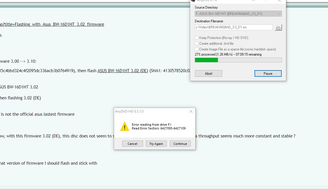

long story short been limping along with an old blu ray drive
it had trouble reading breaking bad box set (Brand new / No Marks) that I have been trying to archive to iso
so after reading forums and recommended drives, I invested in ASUS BW-16D1HT
its no better than the drive I was using, I actually think it has more read errors than my old drive
Thinking of sending it back and getting a refund
Is there any better drives out there
Thank in advance
an .jpg (90.29 KiB) Viewed 29997 times

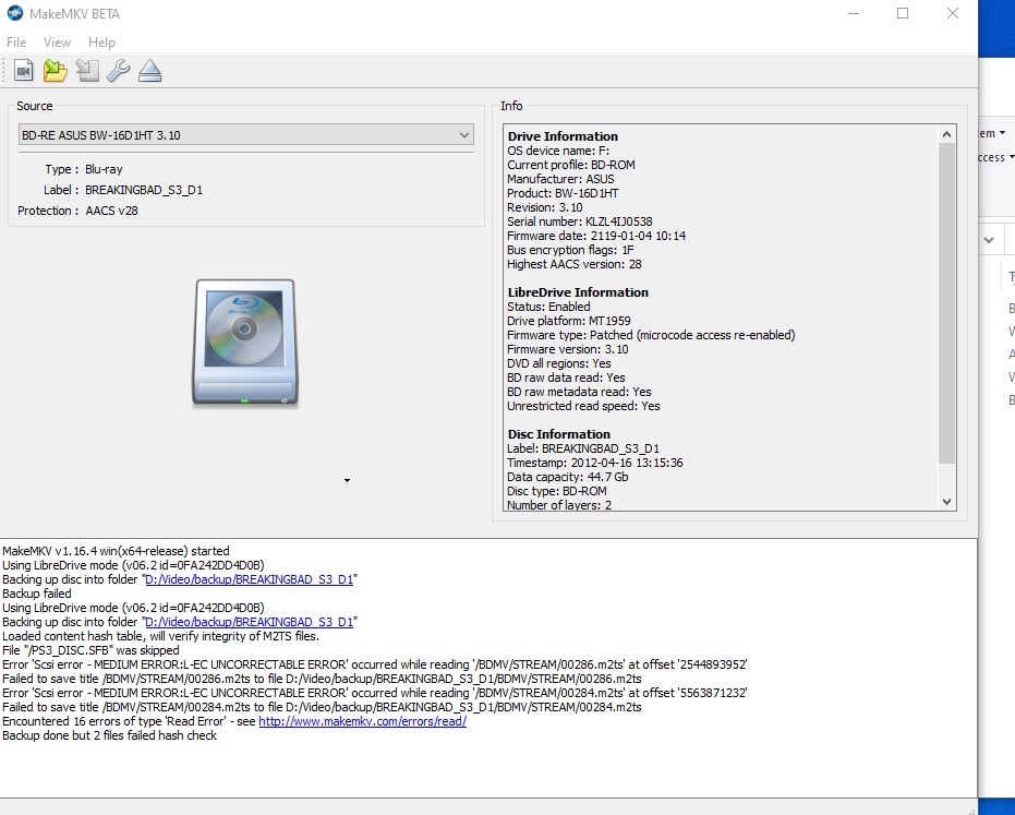

Even after soap warm water and microfibre I was able to rip one of the problematic discs

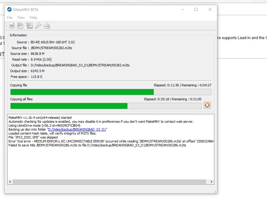

But one of the discs after a clean and using anydvd, halfway through the rip the data flow goes from 24mbs to 0
I can hear the drive stop start / stop start then its back to 24mbs then back to zero
No we go through that section it's flying at 30mbs
Why are the disc stop start dropping to 0mbs ?? why is the data throughput not constant or gaining the more the disc you go through
Regards
Posts: 4535
Re: ASUS BW-16D1HT what a rubbish drive
These symptoms are pointing to mastering errors / discs are pressed badly and the drive has a hard time to read the data correctly. By cleaning you remove an invisible film that additionally makes them hard to read. If cleaning them twice doesn't help to read them out correctly you should return them and get a new set of discs. Your drive is working perfectly OK as you can see now.

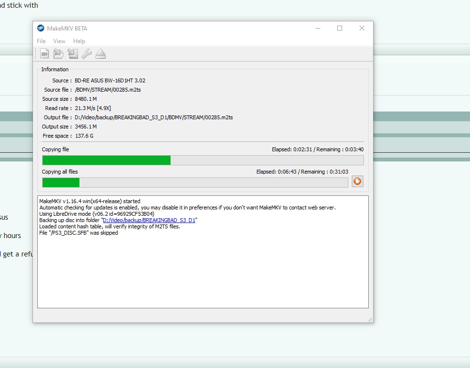

The ASUS and LG drives are manufactured by LG. If you're using ANYDVDHD, Try crossflashing it to the LG WH16NS40 and see if it reads the disc better. Believe it or not, some titles work better with the ASUS BW16D1HT firmware, and other titles work better with the LG WH16NS40 firmware, whether you have ASUS or LG hardware.
Posts: 4535
I usually have 3.10 ASUS firmware for fastest read speed but use 3.02 ASUS for critical discs. 3.02 stays longer at lower read speeds that helps in such cases.
