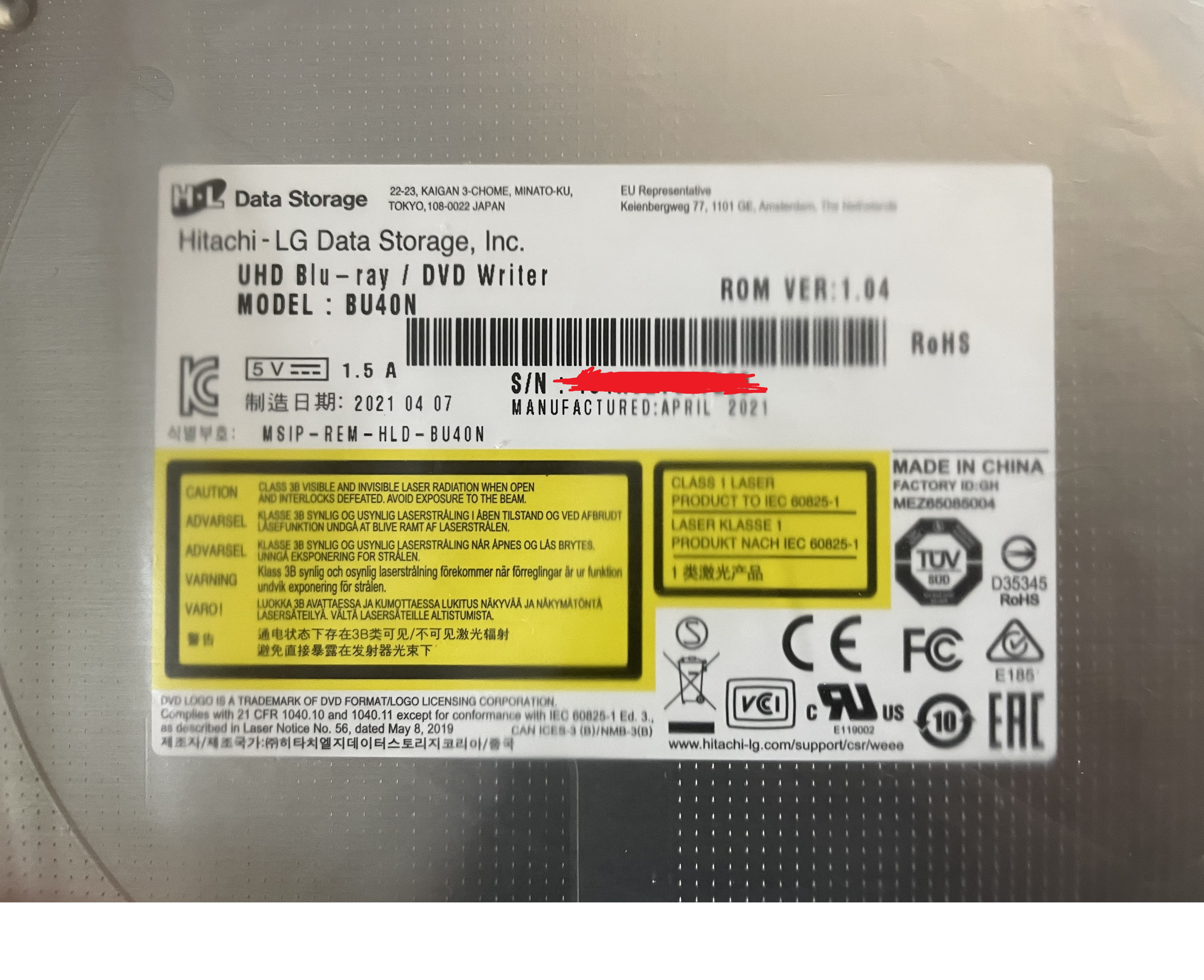

As the title says can't find anything about a SVC label on the drive. Does that mean I'm screwed? Or am i just blind? Thanks for the help!
(Attached image of the label)
Bought a LG BU40N, can't find any "SVC NS50+" label.
- Namnlös.jpg (3.08 MiB) Viewed 11689 times

BU40N's are a different beast and do not have the SVC NS50+ requirement. Looking at the pic, your's looks good. Has 1.04 (encrypted) firmware, so use "enc" when flashing the very first time.
