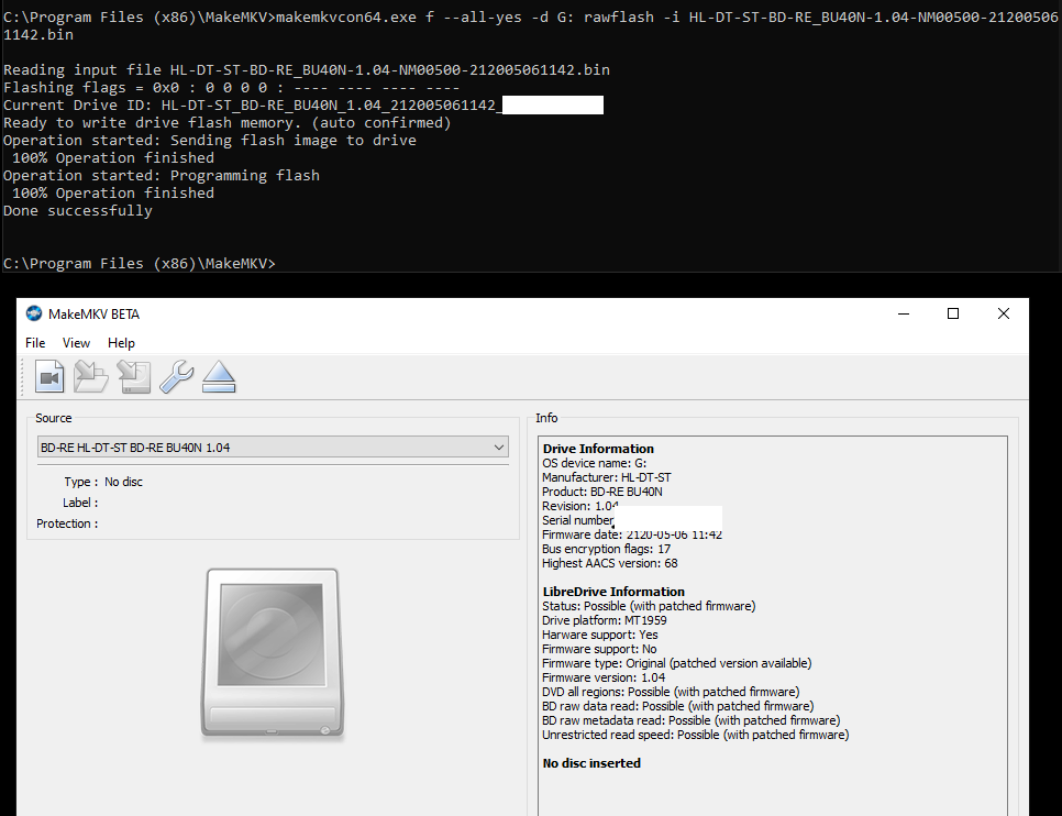

I've attached a screenshot to try and help.
New drive in a Vantec enclosure. As you can see I've run the flash using the .bin from the latest zip in the MK thread, but it doesn't seem to have worked - can anyone provide advice please?

Has the hardware been reset since the flash? As in, powered off so it will re-read its firmware when it powers up?

You didn't use enc
Re: BU40N V1.04 flashed but not enabled?
Ok thanks I'll try again later with the enc flag.
Yes, tried re powering.
Sorted, thank you
