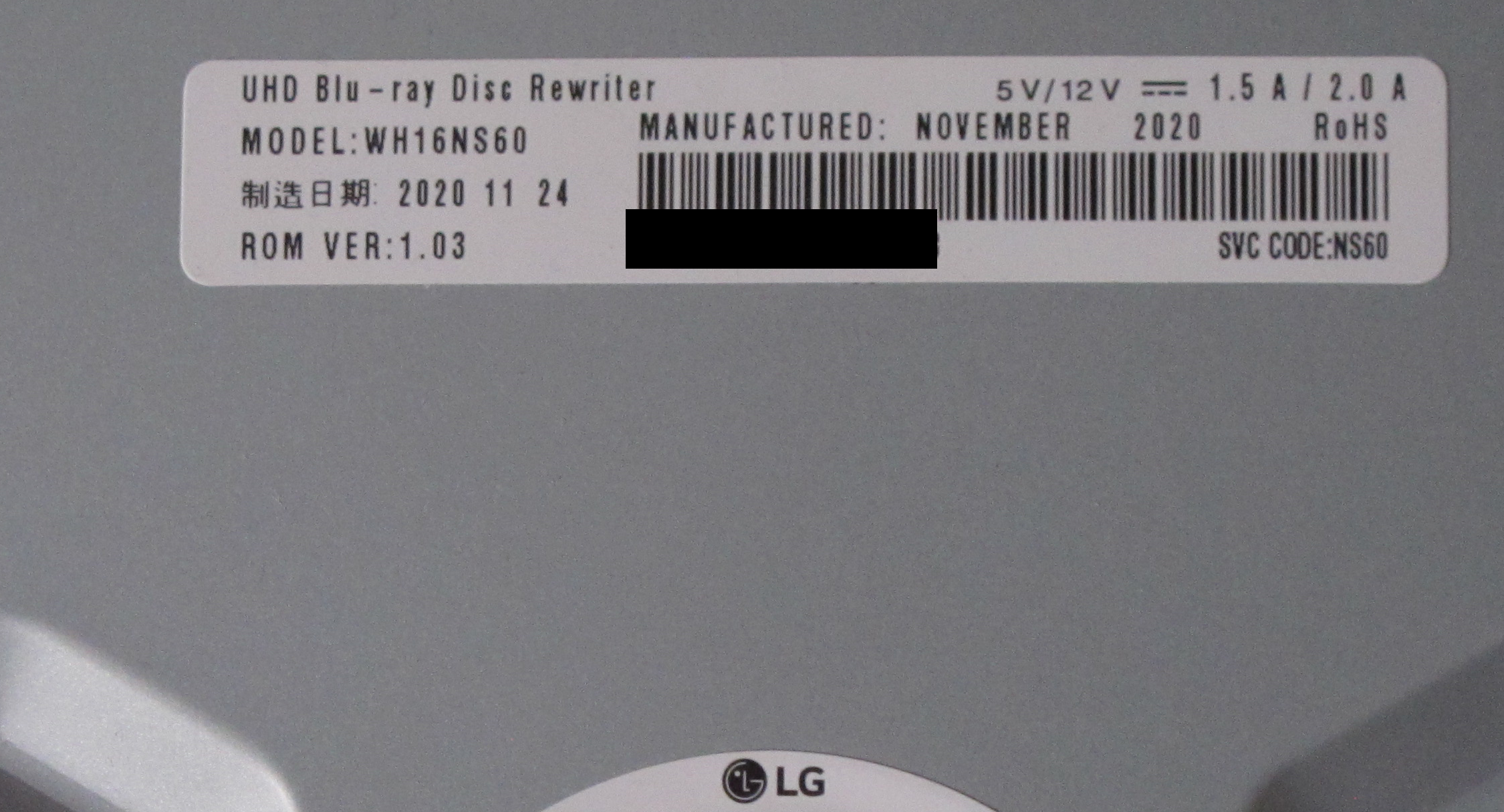

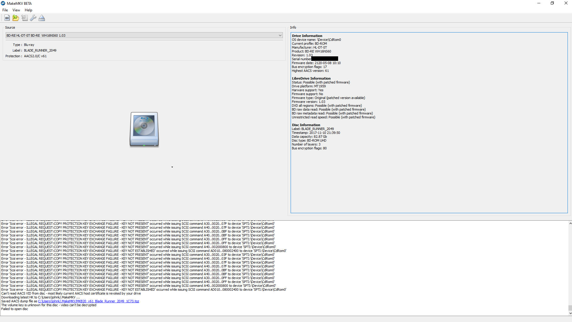

I have a LG drive that isn't flashing
It claims to flash ok :
PS C:\Program Files (x86)\MakeMKV> .\makemkvcon64.exe f --all-yes -d F: rawflash -i C:\Users\johnk\Downloads\HL-DT-ST-BD-RE_WH16NS60-1.02-NM00100-211810291936.bin
Reading input file C:\Users\johnk\Downloads\HL-DT-ST-BD-RE_WH16NS60-1.02-NM00100-211810291936.bin
Current Drive ID: HL-DT-ST_BD-RE__WH16NS60_1.03_212005081010_XXXXXXXXXX
 100% Operation finished
Done successfully
But when I try it afterwards it still lists the original firmware and doesn't work :
Anyone got any suggestions?

You have to add the "enc" option since your original firmware is encrypted. Good Luck!

Per the Ultimate UHD Drives Flashing Guide Updated 2021
Newer OEM Firmwares and encrypted:
New Encrypted firmware
List of Know Encrypted firmware (so far, any firmware with date in 2020 is encrypted)
HL-DT-ST-BD-RE_WH16NS60-1.03-N000600-212005081010.bin
Change your command line to include the 'enc' switch...
.\makemkvcon64.exe f --all-yes -d F: rawflash enc -i C:\Users\johnk\Downloads\HL-DT-ST-BD-RE_WH16NS60-1.02-NM00100-211810291936.bin

Thanks guys, that's done the business - up and working now!
