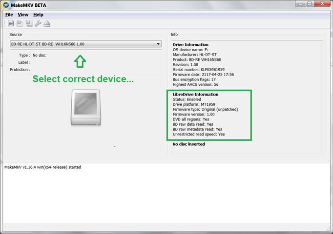

What does MakeMKV 'LibreDrive Information' report? IF yours looks something like this, you should be good to go.
Firmware type: xxx
Firmware version: xxx
Firmware type: xxx

Top, right-hand section of UI...
Untitled (Small).jpg (33.85 KiB) Viewed 9290 times

Firmware type: Patched micro code re-enabled
Firmware version: 1.03

does this mean it should work with makemkv now or will have issues?
Drive is ready to go for UHD w/ MakeMKV. "issues" beyond this remain to be seen.
