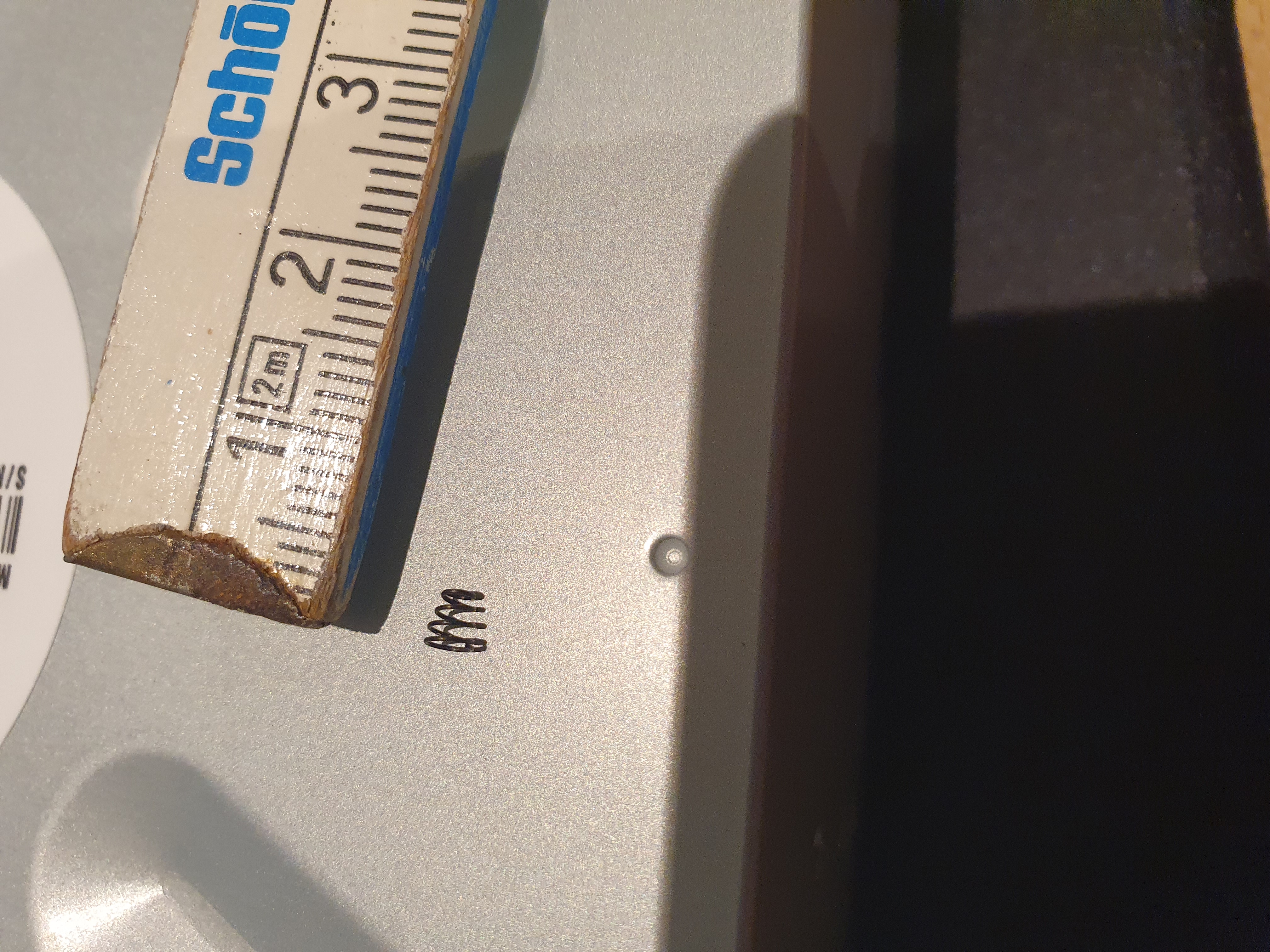

Hey,
i have the same drive BW-16D1HT (built in 2017 with FW 3.00). I used it now for 3,5 years without any problems. The drive is built in an Icy Box 5,25 enclosure with USB 3.0. Never had any issues as i said.
Suddenly it cant read any disks. It is recognized by Windows 10 and MakeMKV as working everything fine.
If i put a disc in both say "no disk". The drive does spins up and trys to read 3 or 4 times then stops.
I flashed it like described in the forum here and tried FW 3.10 and FW 3.01. It didnt change anything. Problem stayed the same "no disc".
Then i disassabled it and cleand the Lasers with Isopropanol. Still no disc can be read.
Is there anything else i can do!? Or do you think its an hardware issue so i will have to buy a new drive?
Thanks for any help in advance!
Greetings and thanks for all the exceptional work!
By the way i foudn this loose in the disk drive. See attached picture.

Sorry! The laser is dead. You need a new drive.

It’s dead time to but a new one. Think I will buy one pre-flashed from one of the sellers here.
