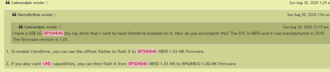

this guy said "If you also want UHD capabilities, you can then flash it from BP50NB40-NB50 1.01-MK to BP60NB10 1.00-MK firmware.".
and as i flash it. now i'm capable of read 4k discs. but real problem is here. that odd no more can't rip audio codec. so if i rip file, only video with no sound comes out. this also happens in blu-ray discs file. before i flash firmware, i can rip blu-ray file with no problem. and as i attempt to rewrite firmware that i used, but this f**king thing can't change firmware anymore
How can i solve this problem? what's wrong with firmware? why they can't rip audiocodec?

Cant rip audio with MakeMKV after flashing?
That’s a new one.
Who was “this guy” that gave you those instructions?
Damn that guy!

jonghotti wrote:
Sun Jan 17, 2021 1:59 am
That’s a new one.
Damn that guy!
From the image, it looks like me!! LOL :D :twisted:
It sounds more like a codec issue on your PC or something.
