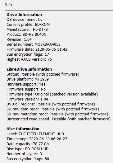

Here is a screenshot of my config and drive:
I am now reading about flashing the drive and trying to use the SDF tool however I am not sure if this is necessary?
If I do need to flash it where the flashing firmware is located (I have read various threads on here about firmware versions but cannot find any links to where these are stored or how to download?
Any help on this would really be appreciated.

Re: I am total confused with the UHD Drives & Flashing - Please help
Hi I recommend you read this: https://www.makemkv.com/forum/viewtopic ... 16&t=19634
And if you don't feel comfortable do it just contact me for a remote flash by email contact info in my signature. and you will be up and running in just a few mins.
