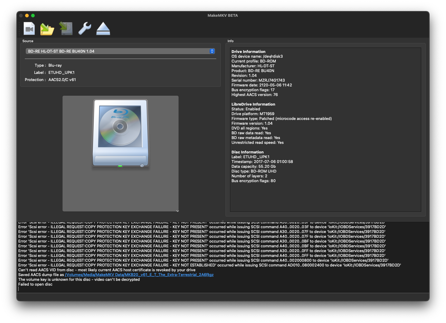

Post by nicholfd »
LG BU40N, UHD Official Internal Slim Sata 9.5mm in a Vantec NST-510S3-BK 9.5mm slim sata case. Connected directly to USB 3.0 port on Mac mini.
Flashed with MK/HL-DT-ST/BU40N-N-Main/HL-DT-ST-BD-RE_BU40N-1.04-NM00500-212005061142.bin from mk-firmware-pack-20200720.zip, using the MakeMKV sdftool from the app
Flash command & output:
/Applications/MakeMKV.app/Contents/MacOS/sdftool -d /IOBDServices/3917BD2D rawflash enc -i Downloads/mk-firmware-pack-20200720/MK/HL-DT-ST/BU40N-N-Main/HL-DT-ST-BD-RE_BU40N-1.04-NM00500-212005061142.bin
Reading input file Downloads/mk-firmware-pack-20200720/MK/HL-DT-ST/BU40N-N-Main/HL-DT-ST-BD-RE_BU40N-1.04-NM00500-212005061142.bin
Current Drive ID: HL-DT-ST_BD-RE_BU40N_1.04_212005061142_MZRJ74G1743
yes
 100% Operation finished
Done successfully
Power cycled the drive (disconnected/re-connected USB cable).
Info from the sdftool after the flash:
/Applications/MakeMKV.app/Contents/MacOS/sdftool --d /IOBDServices/3917BD2D --info
SDF.bin version: 0x007B
Drive Tool SDF present
Drive Specific SDF present
[Drive Specific SDF] Embedded Info Strings:
8000:LibreDrive Information
8013:Status
8105:Enabled
8001:Drive platform
:MT1959
8002:Firmware type
8107:Patched (microcode access re-enabled)
8003:Firmware version
:1.04
8005:DVD all regions
8100:Yes
8006:BD raw data read
8100:Yes
8007:BD raw metadata read
8100:Yes
8009:Unrestricted read speed
8100:Yes
[Drive Specific SDF] Embedded Status Message:
8099:Using LibreDrive mode (v%1 id=%2)
:06.2
:FA108BB7DA63
Identification SDF present
8013:Status
8001:Drive platform
:MT1959
mtk:19:59:BU5 :HL-DT-ST:BD-RE BU40N     1.04:NM00500:-
MakeMKV Info:
OS device name: /dev/rdisk3
Product: BD-RE BU40N
Revision: 1.04
Serial number: MZRJ74G1743
Firmware date: 2120-05-06 11:42
Highest AACS version: 76
Firmware version: 1.04
Disc Information
Label: ETUHD_UPK1
Timestamp: 2017-07-06 01:00:58
Data capacity: 55.20 Gb
Disc type: BD-ROM UHD
Number of layers: 2
Bus encryption flags: 80
Drive works fine for DVD & Blu-Ray. Can't seem to read UHD. After 12+ minutes of the drive thrashing around, changing speeds, I get (several more lines of the Scsi error lines than below):
Error 'Scsi error - ILLEGAL REQUEST:COPY PROTECTION KEY EXCHANGE FAILURE - KEY NOT PRESENT' occurred while issuing SCSI command A40..0020..0FF to device 'IoKit:/IOBDServices/3917BD2D'
Error 'Scsi error - ILLEGAL REQUEST:COPY PROTECTION KEY EXCHANGE FAILURE - KEY NOT PRESENT' occurred while issuing SCSI command A40..002000800 to device 'IoKit:/IOBDServices/3917BD2D'
Error 'Scsi error - ILLEGAL REQUEST:COPY PROTECTION KEY EXCHANGE FAILURE - KEY NOT ESTABLISHED' occurred while issuing SCSI command AD010..080002400 to device 'IoKit:/IOBDServices/3917BD2D'
Saved AACS dump file as /Volumes/Media/MakeMKV Data/MKB20_v61_E_T_The_Extra-Terrestrial_2A6F.tgz
Failed to open disc
I can move the disc to a 5 1/4" desktop drive and read it just fine (disc is ok). I've tried multiple 4K UHD Discs. Some screenshots attached.
What am I missing with this drive?!?!?

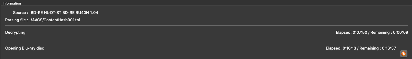

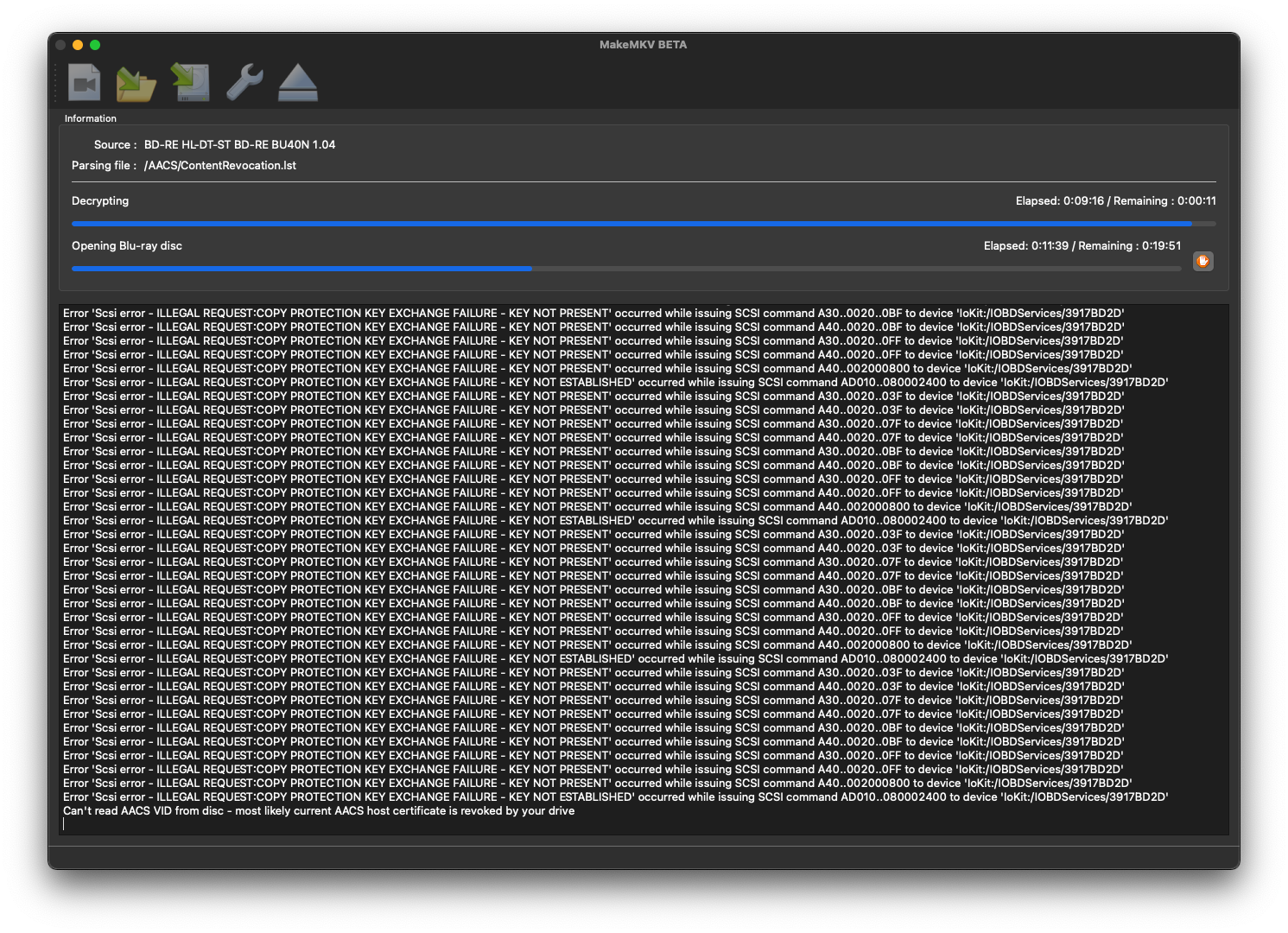

Keeps trying...
Keeps trying...
Then a bunch of errors...
And finally failure.

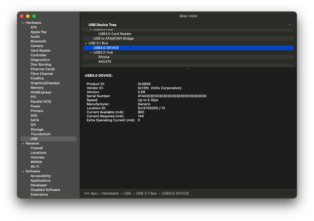

Post by nicholfd »
Billycar11 wrote:
Sat Dec 19, 2020 1:59 am
try a high powered usb HUB
Thanks - I'm using a Mac & the USB ports generally offer plenty of power for anything (more than the typical PC). It's showing 900 mA available. I'll find a powered hub, or the "Y" cable that came with the drive chassis and see if that helps.
Thanks,
Frank
900mA available
900mA available

Post by nicholfd »
I found the Y-USB cable that has two USB-A connectors (came with the drive chassis) - PROBLEM SOLVED! Thanks!
I guess it takes more power to read 4K UHD vs. DVD/Blu-Ray?!?!?! I wonder why?

So which syntax is correct being in the folder I am now?
If you stay in the directory you showed above, inside the MakeMKV app, you would start the command line with `./sdftool ` and add the rest of the command line options for your drive.
Hmm... now I'm not sure which file to choose as I probably should downgrade from 1.01 to 1.00 - there seems not to be any 1.00 binary...
Any ideas?
Not me - my knowledge comes from others in this forum, who are much more knowledgable. Maybe search for another thread with your drive, or start a new thread and specifically ask what firmware for your drive.
