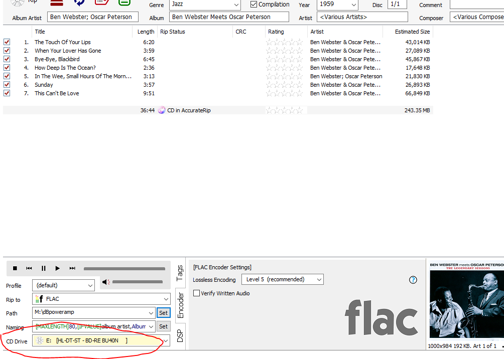

I just added an LG BU40N to my optical drive collection. It's connected to an Intel NUC running Win10 via a USB-slimline SATA lead. Windows can see the drive, and applications such as dbpoweramp can see discs that are loaded. But makemkv cannot find a useable drive when it opens. Likewise, the SDF flashing tool cannot find a useable drive either.

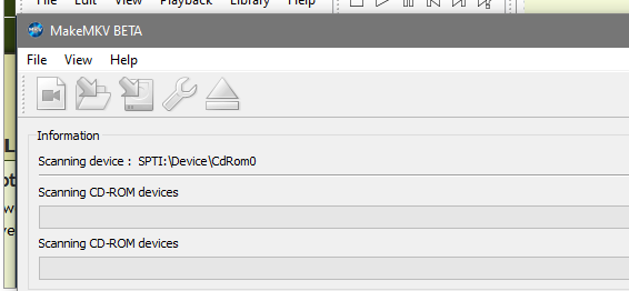

Re: MakeMKV cannot see new LG BU40N drive
I've now connected the LG drive to two other Win10 PC's in the house, and in all cases, makemkv hangs when it opens
But in all cases, Windows has a good device connection at the OS level, e.g. from my Intel NUC, all apps apart from makemkv are good (e.g. Foobar2000, dbpoweramp etc).

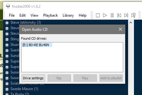

Sure, Foobar plays a CD just fine.

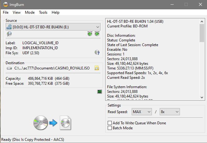

Sure, loading a bluray works fine. Windows asks me which program I want to use. Here is a shot of Imgburn having read all the details on a bluray disc. In the top right, you can see it's happily talking to the LG 1.04 via USB.
MakeMKV works fine with two ASUS drives I have when they are connected via USB, one in an OWC enclosure, the other via an AGPtek USB/SATA interface, so MakeMKV has no problem with seeing those USB connections, but it will not see the LG.
