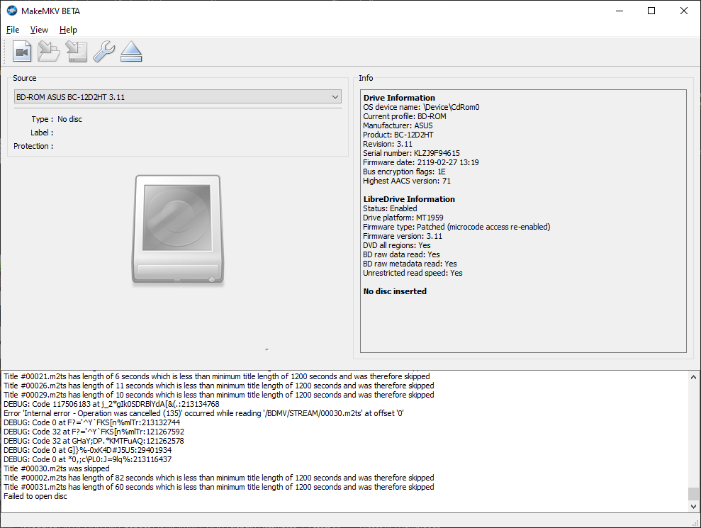

since today I cannot read bluray and UHD-disks reliable anymore.
I use an Asus BW-16D1HT drive and flashed a BC-12D2HT firmware on it with the Asus Odd FW Changer. I attached a screenshot from MakeMKV for all information. This worked since I bought the drive. Until today.
It all started with "The Prestige" by Christopher Nolan in UHD. Initially, it didn't work, it showd "No disk inserted". So I updated the firmware and MakeMKV and then it worked somehow. The next UHD-disk was Dunkirk, everything worked flawlessly and fast. After that I tried "Batman Begins" in UHD and here the trouble started to kick in.
It took some time (around 2 minutes) to recognize the Disk and then the errorcode 002003:0000 Error 'Scsi error - MEDIUM ERROR:L-EC UNCORRECTABLE ERROR' occurred while reading 'BD-ROM ASUS BC-12D2HT 3.11' at offset '2752512'
After that no other disk, whether a normal Bluray that I already ripped succesfully nor UHD disks I ripped succesfully (e.g. Dunkirk) were recoginzed at all. Only "No disc inserted" after a minute or so.
I can provide the log file if that helps.
That said, there are a few "'.tar" and "*.tgz"-files in the MakeMKV folder. I can provide information about them as well if that helps.
I hope someone can provide some help or give me a push in the right direction.
Best regards
Daxelinho

- MakeMKV.png (50.79 KiB) Viewed 33084 times

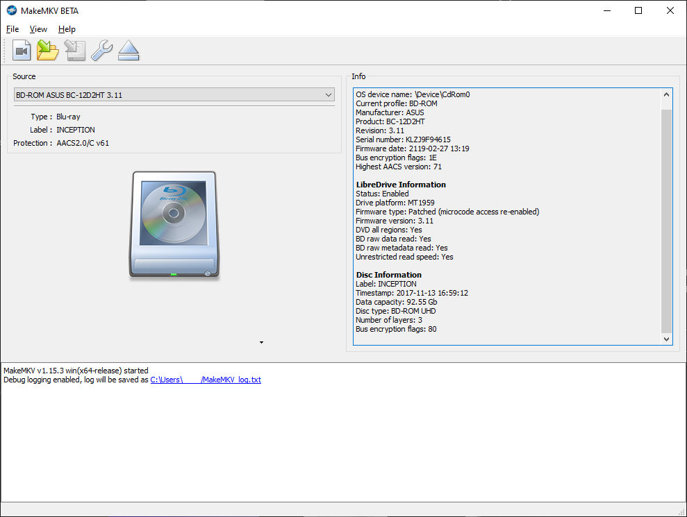

Theres progress!
I was just able to open a disk or at least get it to start loading. It was "Inception" in UHD.
But in the process there were only errors mostly this one:
Error 'Scsi error - MEDIUM ERROR:L-EC UNCORRECTABLE ERROR' occurred while reading '/BDMV/STREAM/00061.m2ts' at offset '0'
Code 100864261 at "-3g'LSG4y)fI{BUb}:121263084
DEBUG: Code 100864261 at "-3g'LSG4y)fI{BUb}:29395149
DEBUG: Code 100864261 at 6U|+czx4G wB(hAY:213139667
DEBUG: Code 100864261 at j7:y}aL_t[):](~/:213130559
Error 'Scsi error - MEDIUM ERROR:L-EC UNCORRECTABLE ERROR' occurred while reading 'BD-ROM ASUS BC-12D2HT 3.11' at offset '1048576'
I attached the log file and a screenshot of MakeMKV

- MakeMKV2.png (64.19 KiB) Viewed 33051 times
- MakeMKV_log.txt
- (845.95 KiB) Downloaded 1150 times
