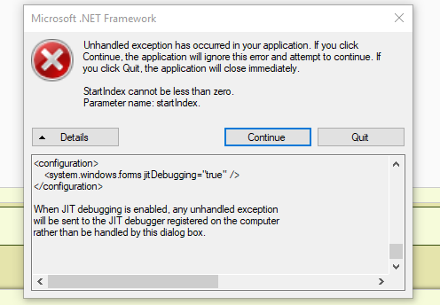

Re: flashing
I have tried sdftool. flasher doesn't open properly I get unhandled exception has occurred if you click continue the application will ignore this error and attempt to continue.
if you quit the application will close immediately. start index cannot be less than zero parameter name start index. I am using windows 10 with latest updates.

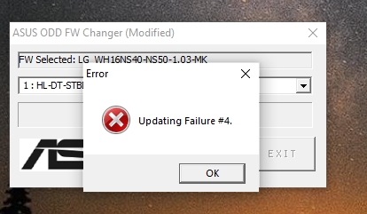

Re: flashing
Which firmware are you trying to flash?
It needs to be 1.03 or 1.04 from the OLD folder. Don't even try 1.05. This is only for drives that come with 1.05 (encrypted firmware).
And you want to check the information about "Microcode" im Makemkv that should say patched after a successful flash.
Re: flashing
maybe that's the problem, if I can get one of the apps to work, was trying 1.02 thanks
Re: flashing
updating with that flasher gives updating failure #4
- Capture.PNG (86.93 KiB) Viewed 21643 times
Re: flashing
See the end of this message for details on invoking
just-in-time (JIT) debugging instead of this dialog box.
************** Exception Text **************
System.ArgumentOutOfRangeException: StartIndex cannot be less than zero.
Parameter name: startIndex
at System.String.Substring(Int32 startIndex, Int32 length)
at sdftool_flasher.Form1.Get_Drive_List()
at sdftool_flasher.Form1.Check_MakeMKV_Installation()
at sdftool_flasher.Form1.Form1_Load(Object sender, EventArgs e)
at System.Windows.Forms.Form.OnLoad(EventArgs e)
at System.Windows.Forms.Form.OnCreateControl()
at System.Windows.Forms.Control.CreateControl(Boolean fIgnoreVisible)
at System.Windows.Forms.Control.CreateControl()
at System.Windows.Forms.Control.WmShowWindow(Message& m)
at System.Windows.Forms.Control.WndProc(Message& m)
at System.Windows.Forms.Form.WmShowWindow(Message& m)
at System.Windows.Forms.NativeWindow.Callback(IntPtr hWnd, Int32 msg, IntPtr wparam, IntPtr lparam)

netframwork error

netframwork error
- Capture.PNG (23.39 KiB) Viewed 21642 times
