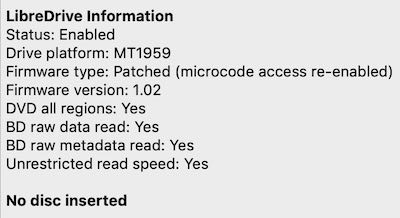

Also how do I know if my drive is "Drive Platform MT1959"?
Posts: 4516
Re: Weird problem with my drive, please help
MakeMKV tells you on the first screen.
Class316
Posts: 19
Joined: Sat Sep 05, 2020 8:32 am
Post by Class316 »
dcoke22 wrote:
Sat Oct 17, 2020 12:09 am
Seems mine checks out here.
So for those 3 conditions
1. Make sure your Drive was built after 2015
Mine says it was built April 2020
2. Drive Platform MT1959<Most important
Make MKV says it is
3. SVC NS50+ LG only
It's an LG drive
So going by all these condition my drive does pass to get cured of the bug.
