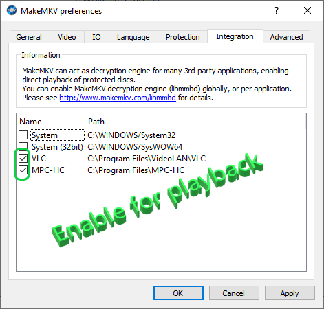

Dear @wizozzy,
thanks to @mike admin's continues efforts, the Pioneer gang (and relatives) has joined the UHD party via LibreDrive membership.
PIONEER-BD-RW___BDR-UD04-1.00-4B3560E3-8A10-20170210
PIONEER-BD-RW___BDR-UD04-1.10-431D03CF-8A10-20170425
PIONEER-BD-RW___BDR-UD04-1.14-489CDFD6-8A10-20200615
Would you try, skinning your Terminator again with the help of the Verbatim 43888 drive?
Please not only try MakeMKV's ripping ability, but also the neat playback feature.
