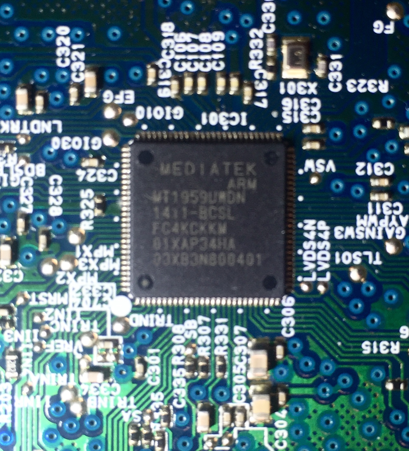

My LGWH16NS40 manufactured May 2014, ROM VER. 1.00, has MT1959.
Since it has MT1959, shouldn't it be UHD, LibreDrive flashable?
If I am right in thinking this, I thought the rest of the community would also be interested in my discovery.

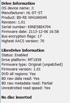

No, curiously MakeMKV reports it as MT1939 and LibreDrive enabled.
20200923 MT1939 actually MT1959 info.JPG (29.47 KiB) Viewed 11825 times
yeah do not flash that drive it will die i have no idea why the chip says 1959

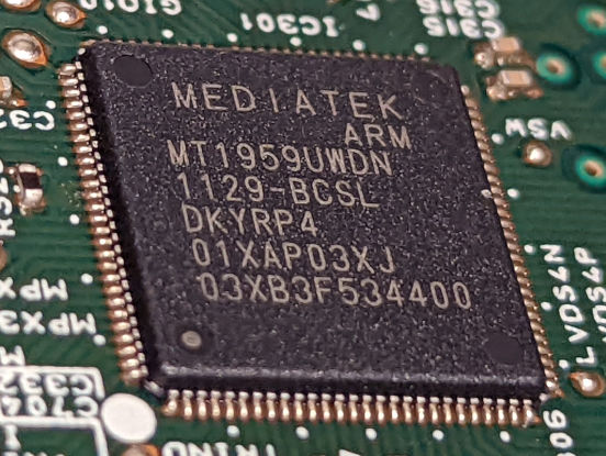

I just wanted to add a datapoint that my 2012 BH14NS40 drive does have a MT1959 chip, but MakeMKV sees it as a 1939.
According to the below table, they're all 1959s.
https://forum.cdrinfo.pl/attachments/f1 ... e_v1.1.pdf
