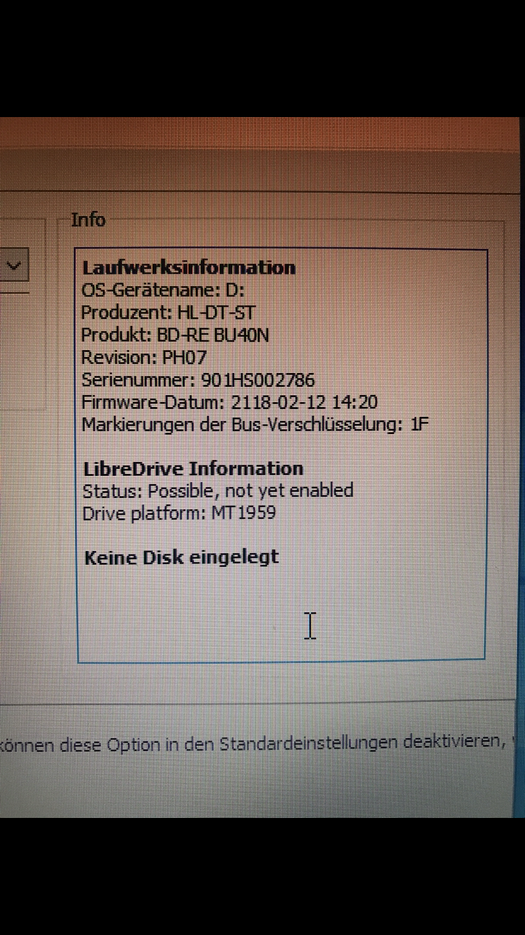

hello,
I bought a used LG BU40N last week.
unfortunately I now had to notice that the drive has an unknown firmware PH07.
can someone tell me something about this firmware version?
thanks.

When you load MakeMKV, what does it say about the drive?

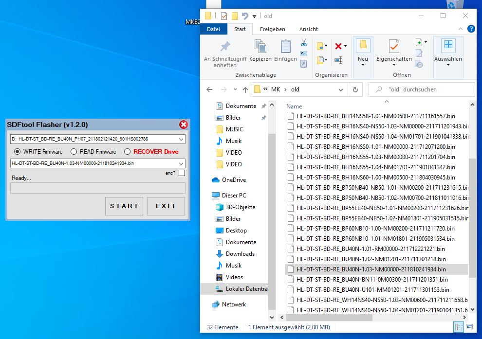

Bommatt wrote:
Sat Sep 19, 2020 8:18 pm
Recommended Firmware to flash for MakeMKV:
BU40N > BU40N 1.03MK
https://www.makemkv.com/forum/viewtopic ... 16&t=19634

Billycar11 wrote:
Sat Sep 19, 2020 10:03 pm
Thank you for your quick response.
So you mean that I can simply flash the 1.03mk over the firmware PH07?
I'm new here.
could you briefly tell me which tool I should use for flashing?

Posts: 4463
Re: LG BU40N with Firmware Revision PH07
The link Billycar11 posted is to the drives guide on this forum. In there, you'll find links to the various firmware, flashing tools, and what not. I think the SDFtool by MartyMcNuts is the preferred choice these days.

Bommatt wrote:
Sat Sep 19, 2020 12:06 pm
Did you notice MakeMKV writing an FW_xxxxxxxx.tgz file for this drive? Should have been created on first disc opening and placed into MakeMKV data directory. Please send this file to support@makemkv.com

mike admin wrote:
Wed Nov 04, 2020 5:18 pm
I would flash my drive like this now.

Bommatt wrote:
Tue Nov 24, 2020 11:02 am
do I need to turn on ENC?
No enc
