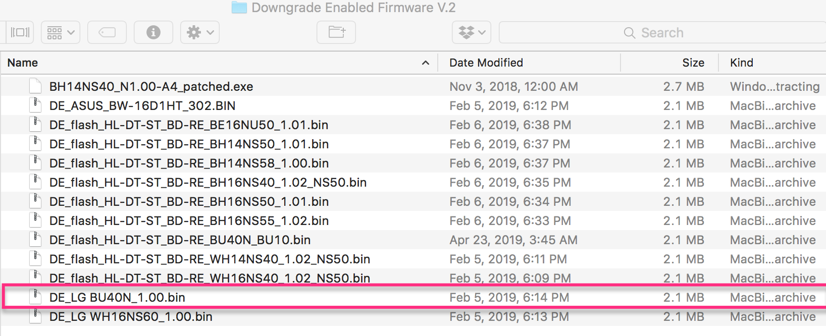

Thanks all for the help and material. I think I'm good to go now except for two last questions
1. Regarding which Libre Firmware to use - I've narrowed them down to two.
From these two I'm unable to tell which one (if either) is ok to use.
Potential LibreDrive Firmware:
HL-DT-ST-BD-RE_BU40N-U101-MM01201-211711301153
HL-DT-ST-BD-RE_BU40N-1.01-RM00000-211712221221
2. Is there a way to tell just by looking at what info is displayed here if I should use the 'enc' flag?

Posts: 1709
Re: command line utils for flashing my new Archgon UHD?
Post by d00zah »
jfields wrote:
Tue Jul 07, 2020 12:36 pm
My take, after reading over that thread, is that once a drive has been flashed w/ v1.04 (new, encrypted), it will only take an encrypted FW going forward. Since you are starting from v1.01, I'm pretty sure flashing an earlier patched FW version will not require the 'enc' flag.
"Put "enc" option (without quotes) after rawflash because if your unit comes with 1.04 it will accept only fw in encrypted format."
As to which image to flash, I'll leave that call to someone with more experience w/ that particular drive.
Alex? ( @jonghotti )

Posts: 5503
Flash it to BU40N 1.00 de
Posts: 4749
For reference:
$ makemkvcon f --list
00: dev_21:2, /dev/sr1, /dev/sr1
  HL-DT-ST_BD-RE_BU40N_1.01_211712221221_Serial number
$ makemkvcon f -d /dev/sr1 help
MTK19xx firmware module v1.21
OS device name: /dev/sr1
Product: BD-RE BU40N
Revision: 1.01
Serial number: Serial number
Firmware date: 2117-12-22 12:21
Bus encryption flags: 1F
Harware support: Yes
Firmware support: No
Firmware version: 1.01
Thanks in advance. Almost there.
Flash with DE_BU40N_1.00 firmware. It is da bomb!

Billycar11 wrote:
Tue Jul 07, 2020 7:51 pm
Awesome. That's actually the one I originally had planned on using. I couldn't find it tho which led me to default to the other two in my 2nd post. Thanks for confirming and all the work you put in!

just wanted to say this thread has been really helpful for flashing my archgon. i just have a question i flashed it to the current BU40N firmware from viewtopic.php?f=19&t=19113#p71880 which is HL-DT-ST-BD-RE_BU40N-1.04-N000500-212005061142.bin whats the differance between that one and the DE one?
mike admin
Posts: 4107
Post by mike admin »
Just version. Yours is 1.04, latest from 2020. The "DE" is 1.00 from 2017, . There are some (other) programs that work with 1.00 but can't with 1.04 - this is about the only reason to flash 1.00 . If you are loyal to MakeMKV, stay on 1.04 :)
