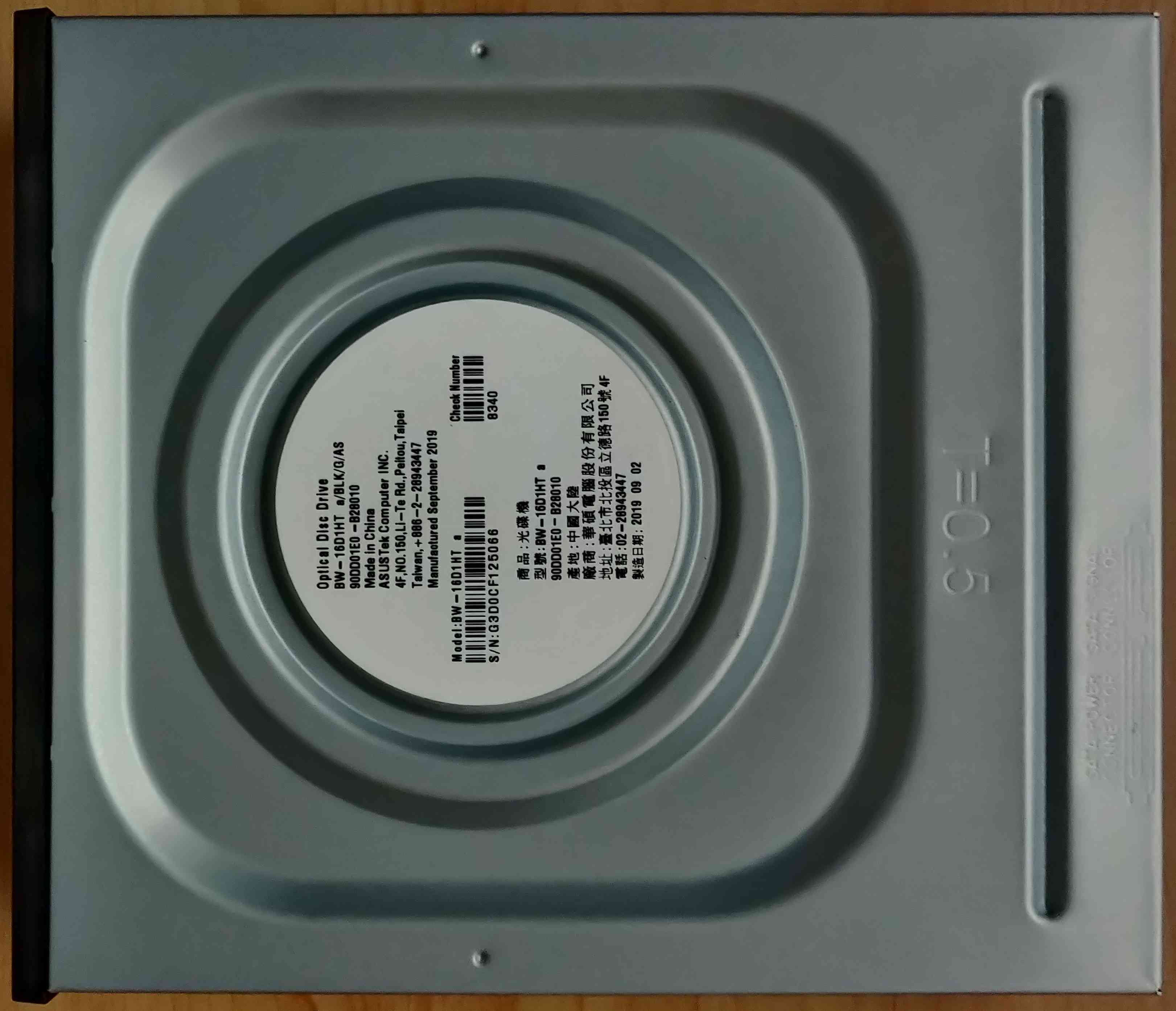

Confirmed.

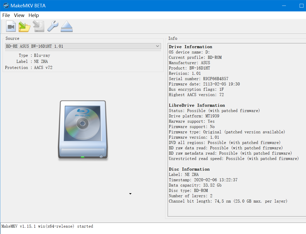

Its an old drive varient 'BW-16D1HT a' without bdxl support its wired that its manufatured in Sept. 2019 which well past the year 2015.
here is how it looks in makemkv:
and this is how the drive looks:

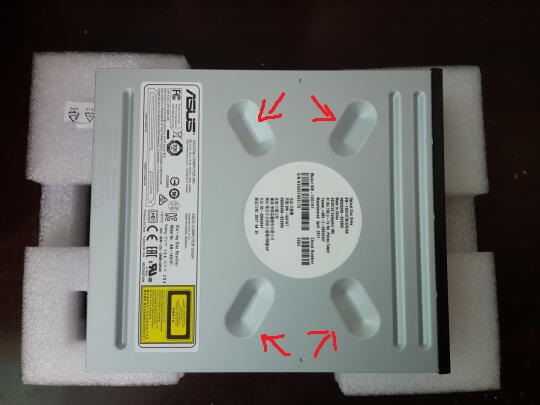

Need to pay attention to the dent patten from top. It looks different to the '4K capable' version of the drive which show bellow.

Thank you for your kindness. I've got a BU40N from somewhere else.I tested it with my laptop and it works just fine with those UHD discs.
Just a heads up, you can spot this fraud one very quickly from its apperence.
Notice that MakeMKV shows the chipset as MT1939 rather than MT1959, and the serial number is also inconsistent with the label. Get to your dealer and ask for a refund immediately if you get one of those.
