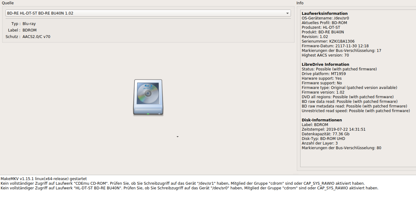

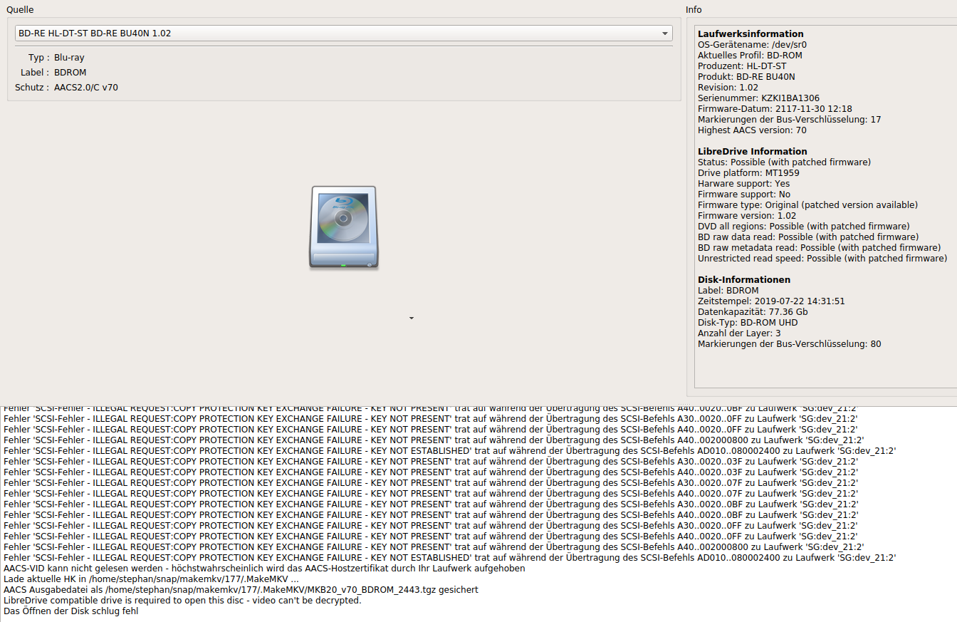

I bought the external UHD-drive mentioned in the subject in Germany and would like to flash it UHD reader-friendly and preferably on a Linux system, Ubuntu 19.04, if necessary I would also have a Windows 10 to run.
Now the turorials here - at least for me - are quite confusing. Can someone explain in simple steps how I can achieve my goal. I would be very grateful to you for that !!!
I enclose pictures of the drive and the installed firmware:
UHD Friendly Drive techPulsel20 = BD-RE BU40N
- 1.png (153.57 KiB) Viewed 7909 times
- 2.png (349.09 KiB) Viewed 7909 times

Re: UHD Friendly Drive techPulsel20 = BD-RE BU40N
I found my way, it was easy, used a Windows 10 system:
Download the windows tool
BH14NS40_N1.00-A4_patched.exe
install it und - in my case - flash with the firmware
DE_LG BU40N_1.00.bin
et voila ...it works.
Remember not to install makemkv via snap.
Useing Ubuntu 19.04, open terminal:
Hope that helps you. Good luck!
sudo add-apt-repository ppa:heyarje/makemkv-betaCode: Select all
sudo apt-get updateCode: Select all
sudo apt-get install makemkv-bin makemkv-oss
