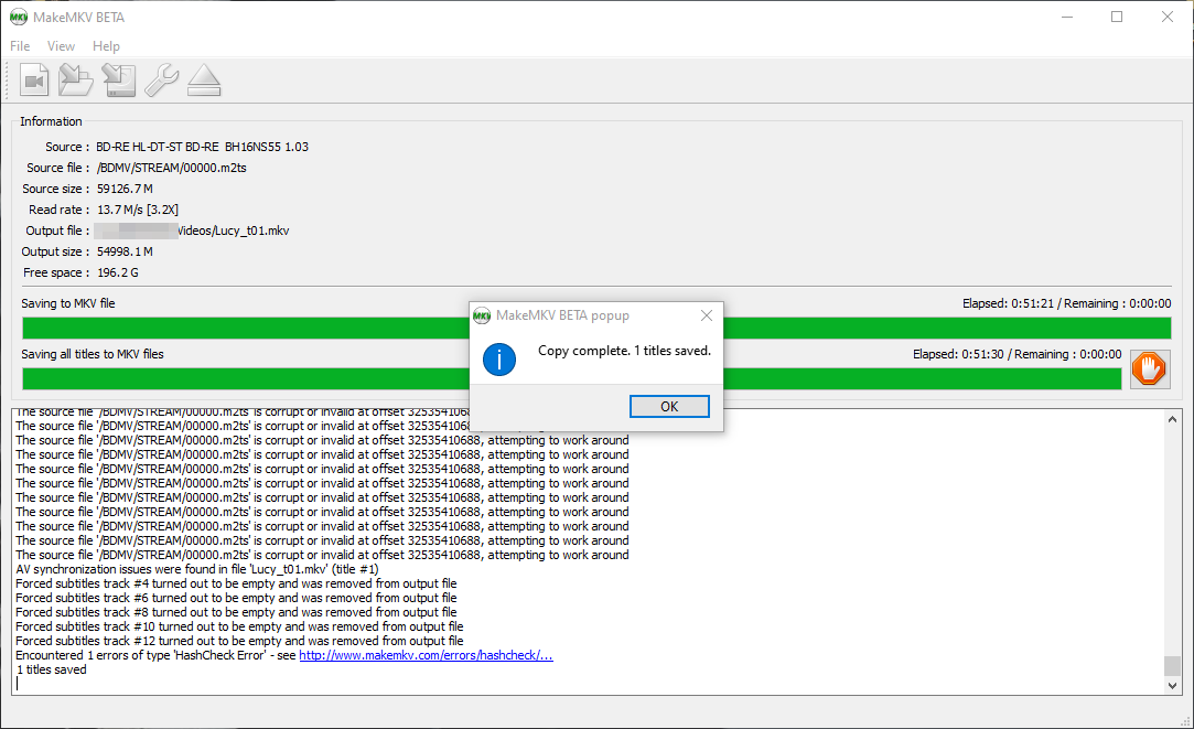

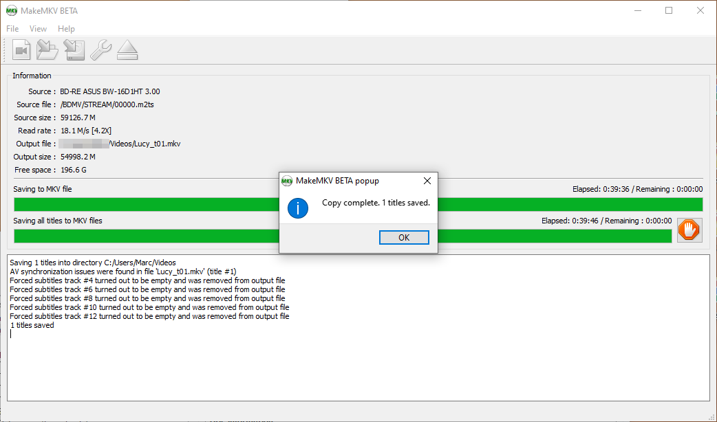

Re: How long do you need to rip UHD Bluerays?
I did a "benchmark":
LG BH16NS55 1.03 needed 51:30 to rip Lucy UHD
Asus BW-16D1HT 3.00 needed 39:46
