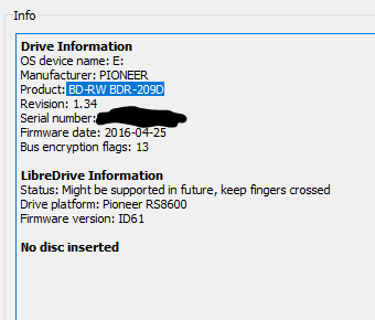

I just realized: I can't seem to find any info that my BDR-209D(BK) supports BD-XL? Isn't BDXL compatibility required for even the slightest chance of my drive becoming UHD Friendly in the future?
drive info.PNG (8.89 KiB) Viewed 61288 times
Posts: 4887

exactly what the libredrive info section shows maybe in the future

So, my drive is BDXL compatibile?
st4evr
Posts: 705
Re: UHD Friendly / Official 4K
Post by st4evr »
nicolaidenmark wrote:
Wed Dec 18, 2019 4:52 pm
"I can't seem to find any info that my BDR-209D(BK) supports BD-XL?"
Can't find info? A quick and simple Google search returns several sources on this. Example:
https://goughlui.com/2014/08/02/review- ... ay-writer/
https://www.google.com/search?client=fi ... JEQ4dUDCAo
In short, no BDXL support on that drive. Libredrive is NOT a magic pill or a "fix for all my problems" solution for UHD backup/ripping. Buy a proper UHD compatible drive from the guide to ensure compatibility now and in the future. Not all drives may be compatible for this and some never will be.

Posts: 10905
BDXL support does not necessarily mean UHD is possible. There are two "flavors" of BDXL, and UHD uses the higher-density one that became available in late 2015.
There are a lot of old-version BDXL drives out there... I own some.
