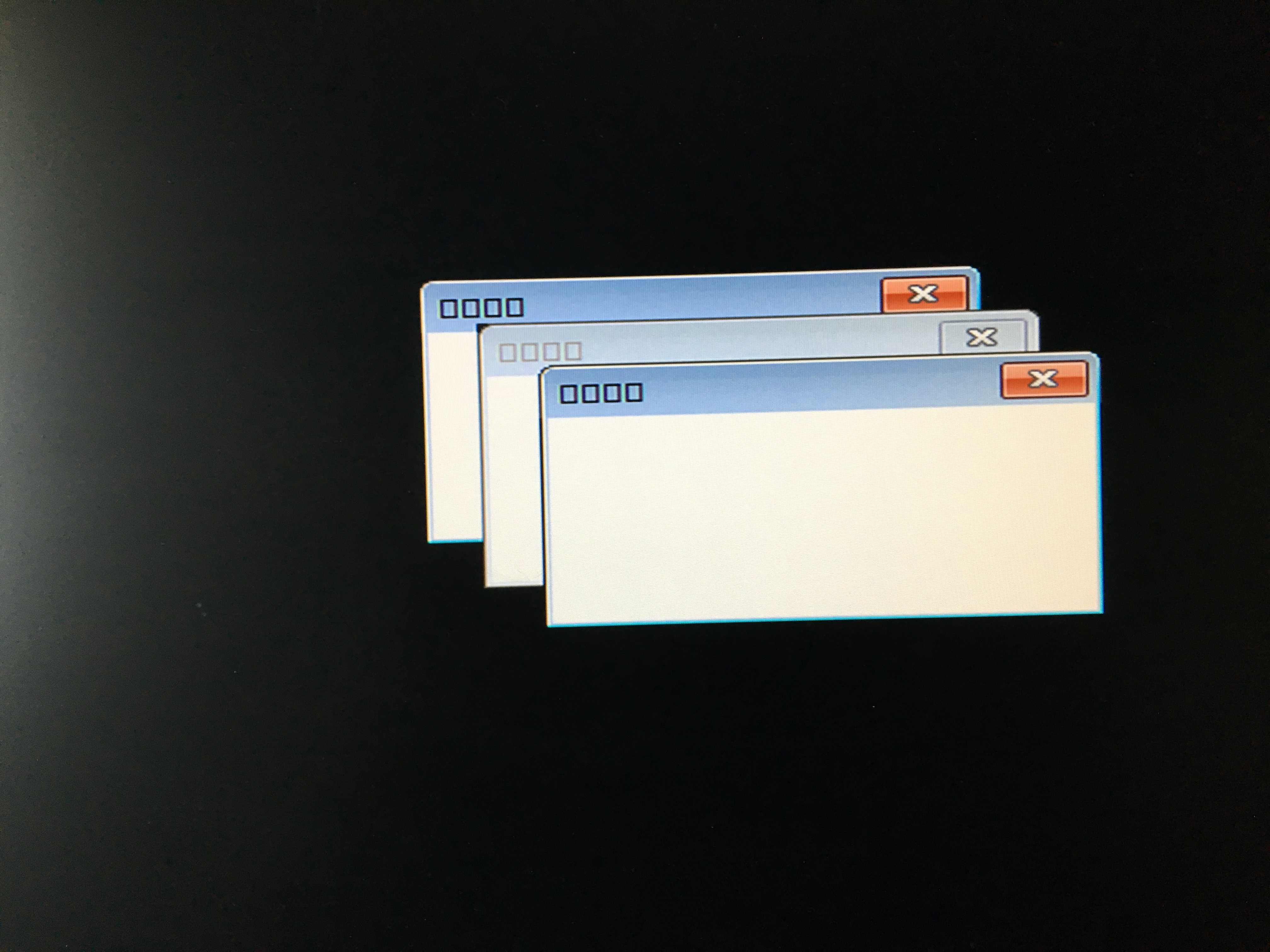

Sadly this is what I get, used Rufus 3.3 and 3.7 to create the USB stick, and then boot from it. I wonder if it's the RTX2060 video card the console is connected to?
Switched to internal Intel graphics, no difference. Sadly, nothing I have tried works.
- Photo Sep 12, 11 56 59 AM.jpg (1.91 MiB) Viewed 26069 times

Why is there a console? You need to boot the PC from the usb stick (not internally from within Linux)
Re: New BW-16D1HT, firmware, linux
That's what I did, boot from the USB stick, Windows loading screen comes up with the spinner, then, I get this.
- Posts: 4780
Not sure what is going on there. It should boot to win10 desktop. I have a GTX 1060 and never had an issue. Maybe some other setting in your bios? Did you follow the instructions text file when creating bootable usb stick, that was with the iso?

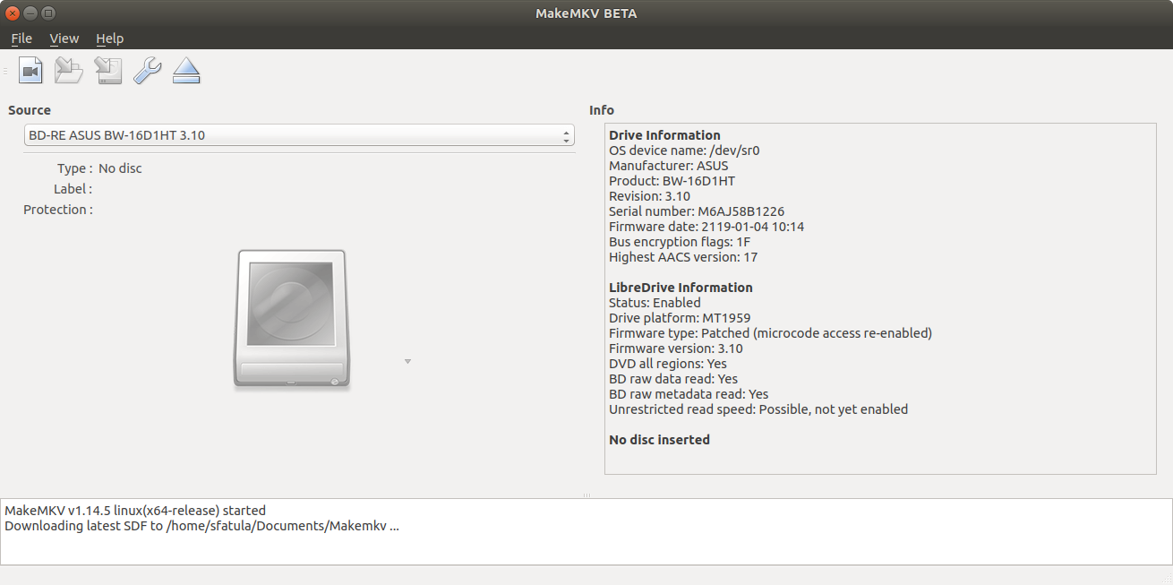

Does this mean all is well for MakeMKV?
- Posts: 4780
Yep, sure does!!
