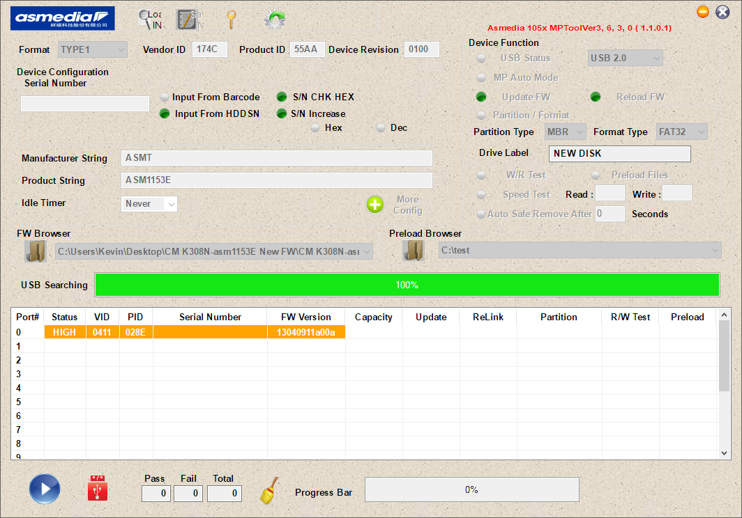

planet1
- Posts: 36
- Joined: Tue Dec 01, 2015 11:00 pm
Good news indeed !
Good evening,
here is an older FW updater called:
fwupdateroddpt_102.exe
It has an even greater model support list (still keeping my fingers crossed that some of those might be UHD compatible with MK FW after all
We can assume that Bufallo uses SATA to USB controllers from Asmedia (ASM 105x).
My drive is detected as follows: Last but not least here is Bufallo's old FW selection webpage and an overview of their optical drive models.
Extracting the EXE-updater yields a 3.5MB firmware file and a FW update utility called Buffalo_105xFWUpg3100_13040911A00A_V1.exe
BRUHD-PU3-BK, BRXL-PT6U3, BRXL-PT6U3-C, BRXL-PT6U3-D
BRXL-PT6U2V, BRXL-PT6U2V-C, BRXL-PT6U2V-D
DVSM-PTS58U2, DVSM-PTS58U2-C, DVSM-PTS58U2-D
DVSM-PT58U2V, DVSM-PT58U2V-C, DVSM-PT58U2V-D

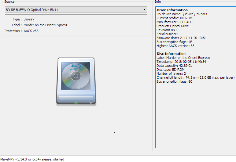

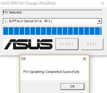

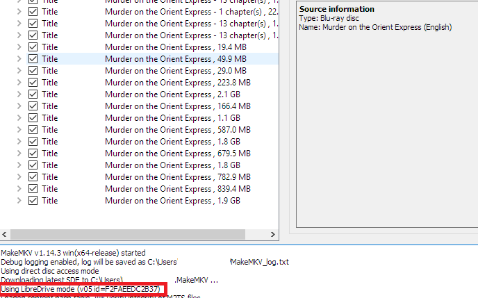

planet1
- Posts: 36
Partial success!
happy news - the crossflash has worked with MartyMcNuts' modified flasher tool,
it can read Blu-ray discs,
and is LIBRE!
Sadly UHD blu-ray discs are still off limits ...
@ mike admin
Sorry, I haven't got the FW version BN10 since I flashed my drive to BN11 a year ago.
What I can tell you though that it also did NOT allow to read UHD discs and was dated 2017-05-30 (vs 2017-11-20 @BN11).
and is LIBRE!
@ mike admin
