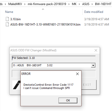

I have an ASUS BD-16D1HT that I'm trying to flash using the tool/image linked at:
viewtopic.php?p=70766#p70766
I've also tried the image file from the 'MK' pack listed at:
viewtopic.php?f=19&t=19113
I run the FW modifier as "Administrator" and selected the .bin file that I renamed to a short name, the drive tray opens and closes, then I see the following error, but I'm not using an enclosure like another thread suggested was the problem. It's directly connected to the Mainboard.
After I rebooted, it did show the downgraded version and I ripped the 4k "Mary Poppins Returns" movie, but the video is messed up after a minute or so (pixelated, not viewable).
Help/suggestions welcome!
DeviceioControl Error: Error Code 1117
I can't issue Command through SPTI
