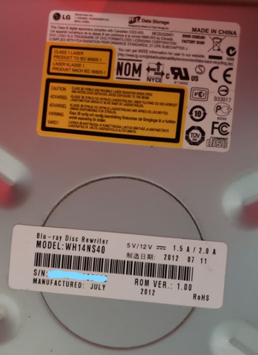

Hey fellas, Its my learning curve lol. Its looks like first messed up drive by me :D
Long story short: I had one old WH14NS40 which is very old without any SV info on label with firmware 1.00. So this was my ideal drive because I bought one from Alex which is works great. Thanks Alex Bro.
I successfully cross flashed this old LG with Asus firmware 3.01 but it can't ready any disk , so I went back to WH14NS40 1.00 back but still its not reading any disk. I guess
its SV code because flashed firmware one was 1.00 NS50 (Which is next generation) . I can't find older WH14NS40 firmware.
OH well not a big deal but curious to make it work again . Any advise please? Also drive label attached.
EDIT: Forgot to mansion I followed this guide https://www.dvd-cloner.com/knowledge/ho ... e_378.html

You're kinda boned on a couple of fronts here...
- You incorrectly identified the drive. The label states '2012' as the mfg. date. NS50 hardware was released in 2017 & most instructions I've read go to great lengths to emphasize this.
- IF you followed the instructions & dumped the old firmware, you can try re-flashing the drive with the dumped image. Many skip this (important) part... damned if I know why. It's rather important.
- The LG support site has firmware images for the older NS40 HW version drives:
https://www.lg.com/us/support-product/lg-WH14NS40
All but the 1st 'New firmware(N1.03) for WH14NS40' apply to the older drive, but IF you didn't do the dump/merge with a clean image, you've lost you drive's calibration data. Some have reported success with a dump from another drive (same model), but it's if-y.

Thanks d00zah
I would try. Nothing to lose. Its already dead not reading at all. But at least still showing up in dos flash stuff for flashing purpose :D
By any chance do you know where can I find dumped for this older version of WH14NS40.
Also from your link for LG website , there regular flasher throwing back error when I go with any version such as 1.03

So you passed on the dump. My WH14NS40 was sent to a new home when I determined it couldn't be upgraded... I'm heartless that way. :twisted: Maybe some community member will be able to help out? Stock flashers probably now see the drive as whatever drive's firmware you used for the failed update... incompatible.

Unfortunately yeah i passed on saving a copy on usb stick. Learn lesson. :D
I will keep searching for older WH14NS40 dumped bin. If I can't find then RIP :cry:

I think even if you make it work again its not even UHD friendly due to older version so its useless. The one that you sent me works like a charm.
Do u think from my pic, is it UHD friendly? its really old.

As both Alex and d00zah advised in two separate post regarding that drive just below your post it is NOT and will never be UHD friendly. So, for a third time, no.
You mentioned you already purchased a working UHD Friendly drive so save yourself the time, money, and headache and move on. If you really feel like you need a second drive, just buy another working UHD friendly drive and recycle that old obsolete bricked drive.
