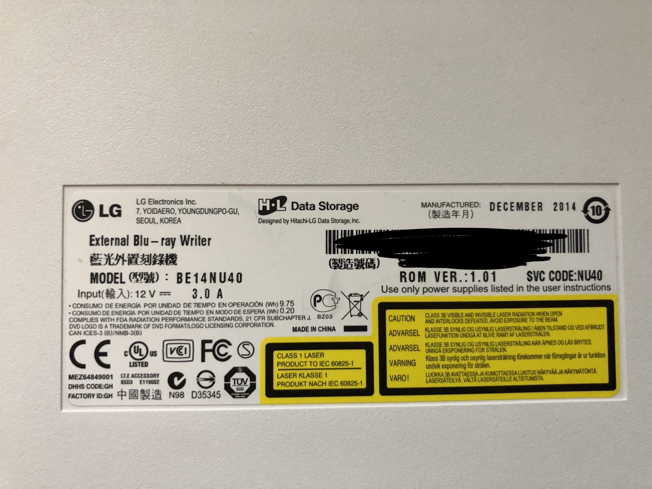

Re: LG BE16NU50 for Ripping 4K UHD
The screenshot has everything. Svc code is not 50 but the LG website says it can read BDXL drives. Am confused.
Simple, you need to ensure you are on the correct firmware. There are literally hundreds of posts in this forum and around the web on this subject/issue. You need to do some further reading/research to ensure you have the correct firmware/hardware combo for proper UHD BD ripping.
Re: LG BE14NU40 for Ripping 4K UHD
Unfortunately, the NS40 service code is a no-go as far as BDXL, even though the website says it supports BDXL. I know; I have an NS40 drive, and it cannot read a UHD disk.
The difference seems to be BDXL data vs. video disks. The NS40 service code drives can deal with a triple-layer data disk, but not a triple-layer video disk. And the only place you see triple-layers right now is in video disks.
NS50 fixed that, and the difference apparently isn't just in the firmware.
What Woodstock said plus Read:Sush1988 wrote:The screenshot has everything. Svc code is not 50 but the LG website says it can read BDXL drives. Am confused.
https://www.myce.com/news/the-ultimate- ... ive-83254/
You have an old version of the drive "pre-UHD Friendly" manufacture date.
