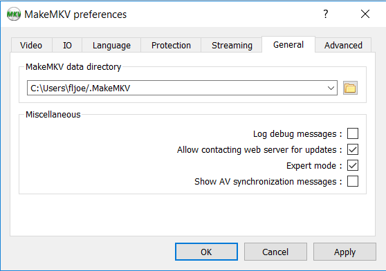

Does "View -> Preferences -> General" show the above data directory? Mine was set in Users .. hence the question ...d4thev wrote:I mean as far as the hashed keys are concerned I am simply putting the text file of the hashed keys in the folder where MakeMKV has designated the data directory right? In my case the data directory is "D:/Program Files (x86)/MakeMKV" so I just have the txt file of the hashed keys in there. Cleanliness of the disk it is brand new, just opened, looks spotless, but I guess I can try cleaning it.

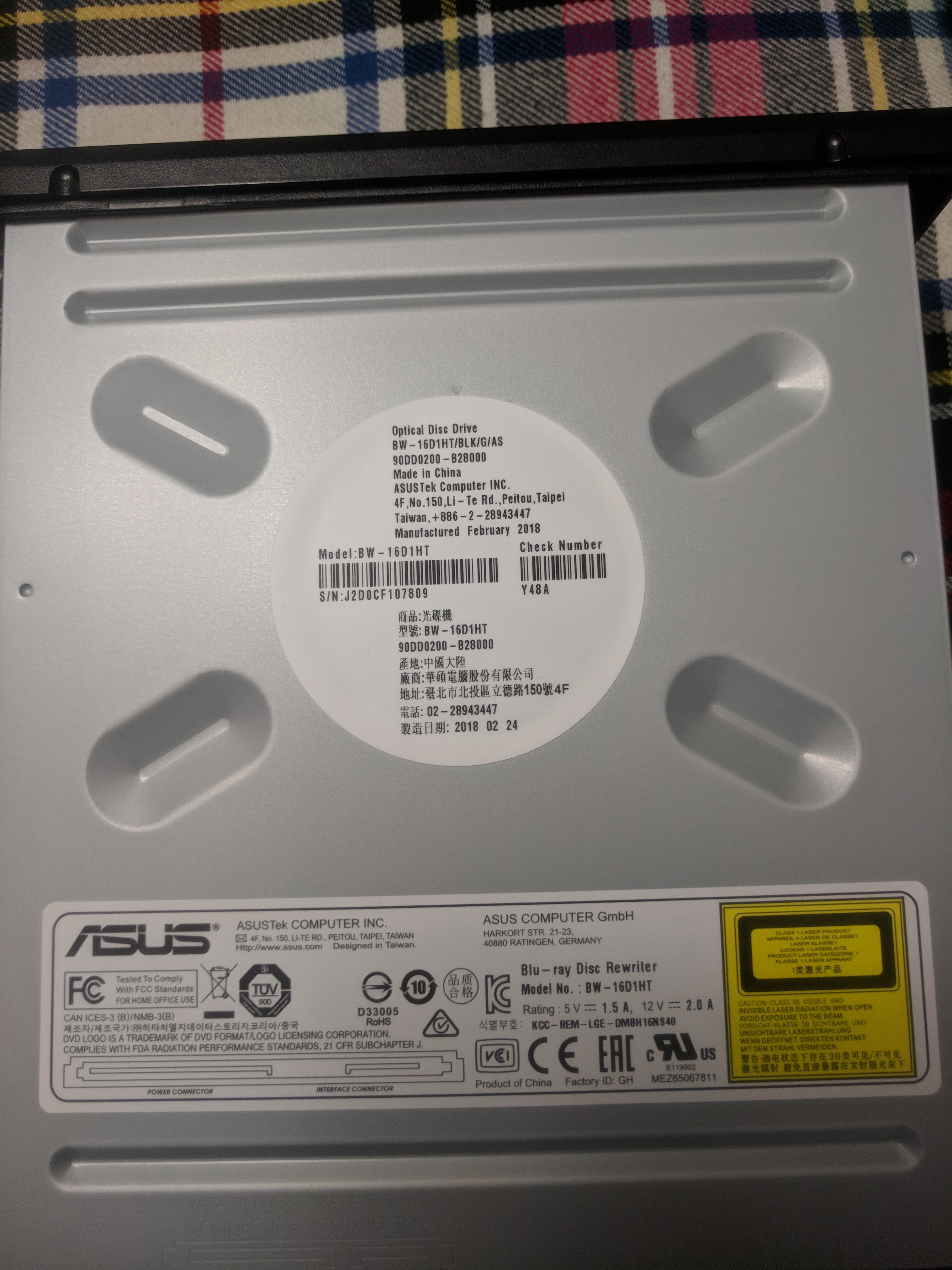

- My drive label
- IMG_20180423_215407.jpg (3.21 MiB) Viewed 37791 times

Mine just appears to be where MakeMKV is installed. Again so I am simply putting the text file of the hashed keys in there?fljoemon wrote:Does "View -> Preferences -> General" show the above data directory? Mine was set in Users .. hence the question ...d4thev wrote:I mean as far as the hashed keys are concerned I am simply putting the text file of the hashed keys in the folder where MakeMKV has designated the data directory right? In my case the data directory is "D:/Program Files (x86)/MakeMKV" so I just have the txt file of the hashed keys in there. Cleanliness of the disk it is brand new, just opened, looks spotless, but I guess I can try cleaning it.
How do I check with smartieyoung to see what he did?
- MakeMKV data directory.jpg (42.16 KiB) Viewed 37790 times

Manufacturing date is Feb 2018, so I'm guessing this case applies:
http://www.makemkv.com/forum2/viewtopic ... 414#p62461
& you'll need to find a way to downgrade the FW. A friend with a PC w/ SATA ports?

If you do not have access to a PC to downgrade the firmware, you best bet would be to return this drive and get one from a forum member who sells these.

If it shows the install directory, you should change it to something else - that directory is not normally writable.d4thev wrote:Mine just appears to be where MakeMKV is installed. Again so I am simply putting the text file of the hashed keys in there?
