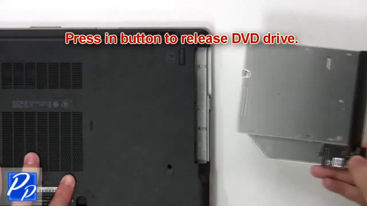

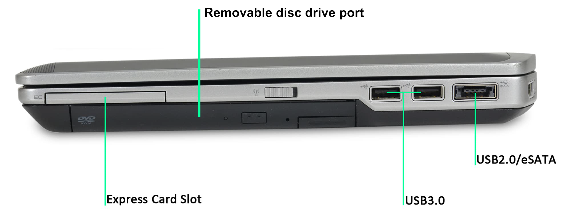

Thank you for the recommendations. I discovered today that my old Dell E6430S laptop works flawlessly for ripping normal Blu-rays over a USB drive. This information has made me think that my old laptop would be able to also work well with the LG BU40N slim drive for UHD discs. The only question I have is is there any way to tell if the SATA connection on that device would support flashing?
I attached 2 pictures that show what the slim drive port looks like on this device.

- Backside of the Dell laptop
- Parts-People Dell Laptop Experts.png (367.92 KiB) Viewed 20532 times
- Labeled side view of the Dell laptop
- Dell Latitude E6430 Laptop Drive (edited).png (395.32 KiB) Viewed 20532 times
- Posts: 4760
Re: What is the cheapest Ultra HD Blu-ray compatible drive?
The BU40N is a 9.5mm drive. You need to check what size the current drive is. It's hard to tell from the image but it may be a 12.5mm drive. For us to advise on the SATA connection you need to remove the drive and show us the back of it.YouAcheDee wrote: ↑Tue Apr 29, 2025 4:17 pmThank you for the recommendations. I discovered today that my old Dell E6430S laptop works flawlessly for ripping normal Blu-rays over a USB drive. This information has made me think that my old laptop would be able to also work well with the LG BU40N slim drive for UHD discs. The only question I have is is there any way to tell if the SATA connection on that device would support flashing?

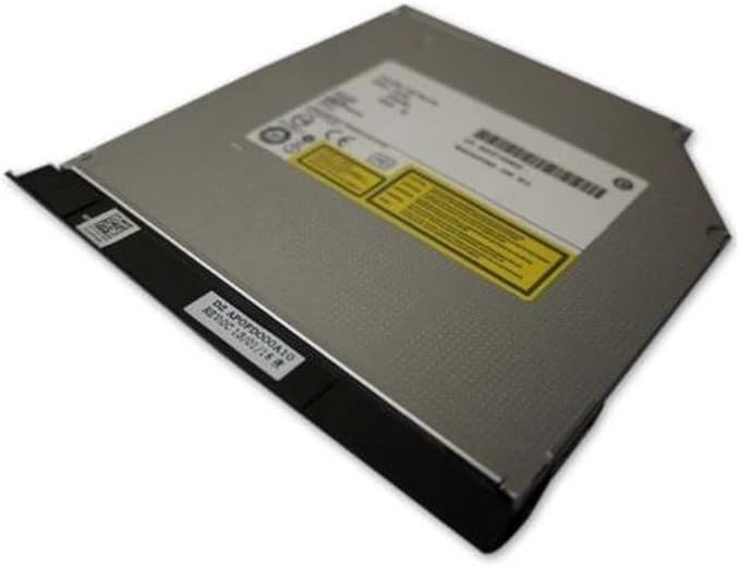

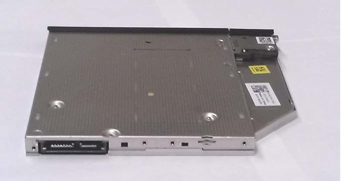

Thanks for the instructions. Attached are 2 images from an Amazon listing of the replacement drive for reference and a section of the Dell Latitude E6430 owner's manual that contains information on the original DVD drive is linked below. In the owner's manual, pages 20-22 are the only pages that may contain relevant information. The owner's manual section may not be needed; I only attached a link to it incase the information is useful.
I do not currently have access to the DVD drive that goes into this computer as it was removed quite a while ago, however some information on Google has me believe that the laptop is compatible with 9.5mm. I was, however, able to get some of the dimensions of the drive port. The currently empty optical drive port is 5.25 inches in length, 0.25 inches tall, and I could not take a depth measurement. I could not find very much information online about what defines a drive's mm measurement, example 9.5mm or 12mm, but linked below are some information sources.

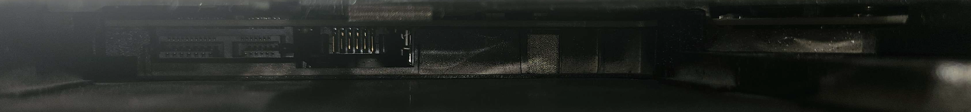

A have also attached a picture that I took of the inside of the computer's empty optical drive port.

- Inside of the laptop's empty optical drive port
- Dell Latitude E6430 Empty Optical Drive Port Picture 1.png (892.42 KiB) Viewed 20387 times
- Amazon Dell laptop listing image view 1
- Dell Latitude E6430 Replacement DVD Drive Picture 1.jpg (19.12 KiB) Viewed 20389 times
- Amazon Dell laptop listing image view 2
- Dell Latitude E6430 Replacement DVD Drive Picture 2.jpg (15.19 KiB) Viewed 20389 times
- Posts: 4760
So it appears to be a 9.5mm drive, same as the BU40N. It should fit but ther may possibly be gaps around the drive bezel as the original drive/laptop has it's own bezel. You won't know for sure until you try...YouAcheDee wrote: ↑Wed Apr 30, 2025 5:41 pmThanks for the instructions. Attached are 2 images from an Amazon listing of the replacement drive for reference and a section of the Dell Latitude E6430 owner's manual that contains information on the original DVD drive is linked below. In the owner's manual, pages 20-22 are the only pages that may contain relevant information. The owner's manual section may not be needed; I only attached a link to it incase the information is useful.
