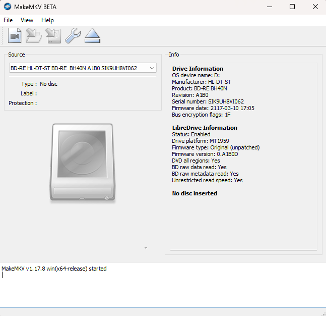

- MakeMKV screenshot
- Screenshot 2024-12-24 191852.png (43.6 KiB) Viewed 7610 times

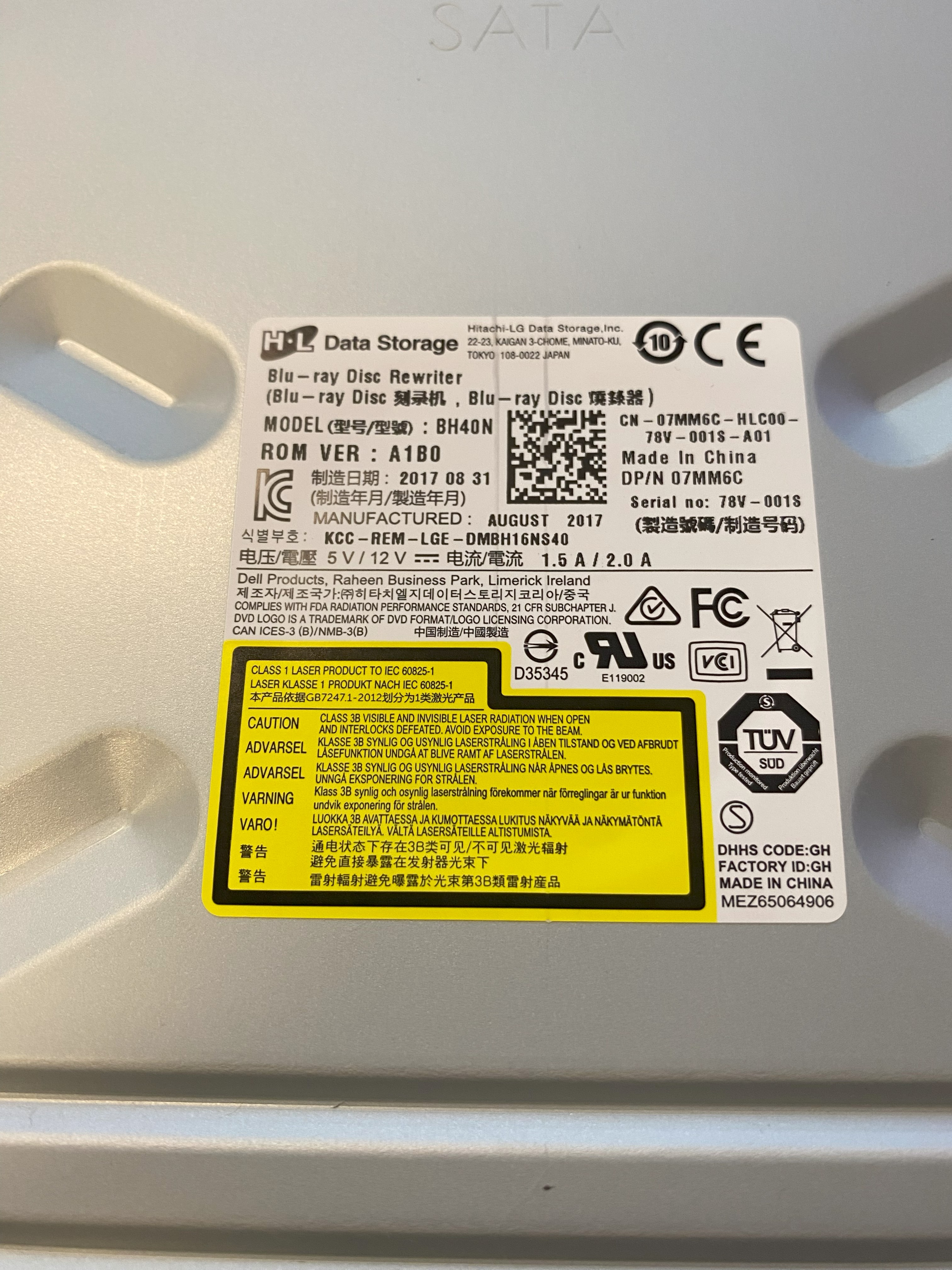

- drive sticker
- IMG_1213.jpg (2.26 MiB) Viewed 7517 times

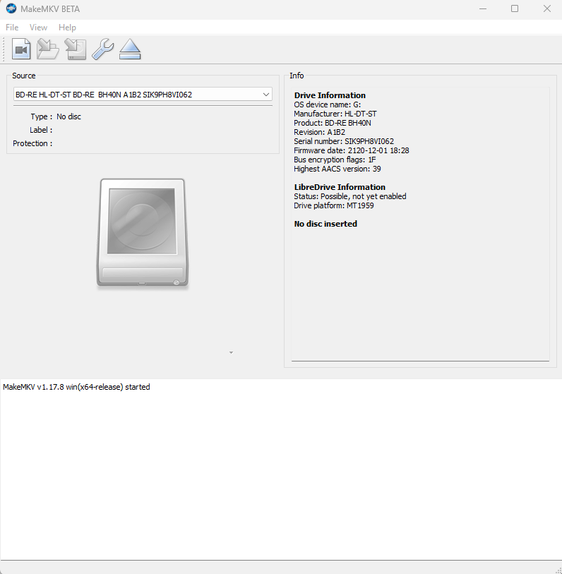

- Libredrive screenshot
- Screenshot 2024-12-26 101807.png (44.61 KiB) Viewed 7517 times

Re: BD-RE BH40N Will not play BD's in windows
Ok, so it's an internal desktop drive. Not a slim drive like a BU40N. I've never heard of this model before.dudegod wrote: ↑Thu Dec 26, 2024 3:27 pmHere is Libredrive enabled on the other drive, and a pic of the stickerMartyMcNuts wrote: ↑Wed Dec 25, 2024 11:48 amUHD discs require libredrive. You need to flash a UHD capable firmware that will enable libredrive. I don’t know what a BH40N is. If it is the same thing as a BU40N, then use BU40N 1.03-Mk firmware.dudegod wrote: ↑Wed Dec 25, 2024 12:44 amHey all new account but have browsed the forum for a long time.

What you need to remember is libredrive does not equal UHD readability. There are lots of Blu-ray drives that have libredrive enabled that can't read UHD discs.
If you are willing to risk bricking one of them, you could try cross-flashing it to WH16NS60 1.02-MK firmware. I suggest testing this on the other one that doesn't have libredrive enabled. The main thing is the manufacturing date is 2016 or newer and the drive platform is MT1959.

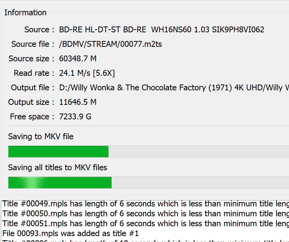

So far so good! It took the WH16NS60 1.03-MK firmware flash just fine and testing now copying a UHD, let me know if there is any info i can provide for the community

will try a new usb cable and see, but here it is through sata working great. Highest speed i saw was 33.0 M/s 7.7x
