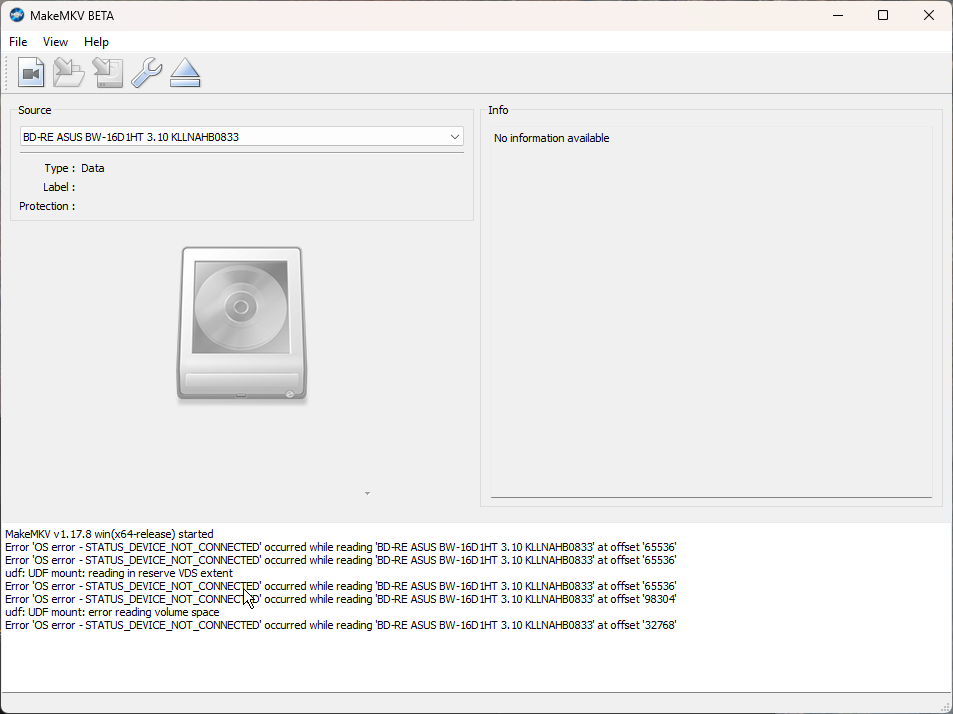

Hello - I have just bought an Asus BW-16D1HT. I have flashed it to 3.10 using SDFtool Flasher. I cant' get MakeMKV to ready any disc, DVD, Blu-ray or UHD (before or after flashing). I am able to play DVD's in VLC, but can't play Blu-rays in VLC. I seem to get various different errors in MakeMKV, so am a bit baffled. Is this just a 'bad' drive? Any advice greatly appreciated. Have tried different USB ports as well.
MakeMKV v1.17.8 win(x64-release) started
Error 'OS error - STATUS_DEVICE_NOT_CONNECTED' occurred while reading '/AACS/MKB_RO.inf' at offset '0'
Error 'OS error - STATUS_DEVICE_NOT_CONNECTED' occurred while reading '/AACS/Content000.cer' at offset '0'
Error 'OS error - STATUS_DEVICE_NOT_CONNECTED' occurred while reading 'BD-RE ASUS BW-16D1HT 3.10 KLLNAHB0833' at offset '65536'
udf: UDF mount: reading in reserve VDS extent
Error 'OS error - STATUS_DEVICE_NOT_CONNECTED' occurred while reading 'BD-RE ASUS BW-16D1HT 3.10 KLLNAHB0833' at offset '98304'
udf: UDF mount: error reading volume space
Error 'OS error - STATUS_DEVICE_NOT_CONNECTED' occurred while reading 'BD-RE ASUS BW-16D1HT 3.10 KLLNAHB0833' at offset '32768'
Error 'OS error - STATUS_DEVICE_NOT_CONNECTED' occurred while reading 'BD-RE ASUS BW-16D1HT 3.10 KLLNAHB0833' at offset '589824'
udf: node fe/efe failed!

Thanks, I've rebooted multiple times, disconnected/reconnected the drive multiples times and tried various discs, but it never works. Managed to get drive info from MakeMKV:
OS device name: J:
Manufacturer: ASUS
Product: BW-16D1HT
Revision: 3.10
Serial number: ###########
Firmware date: 2119-01-04 10:14
Bus encryption flags: 1F
Highest AACS version: 77
Firmware version: 3.10
