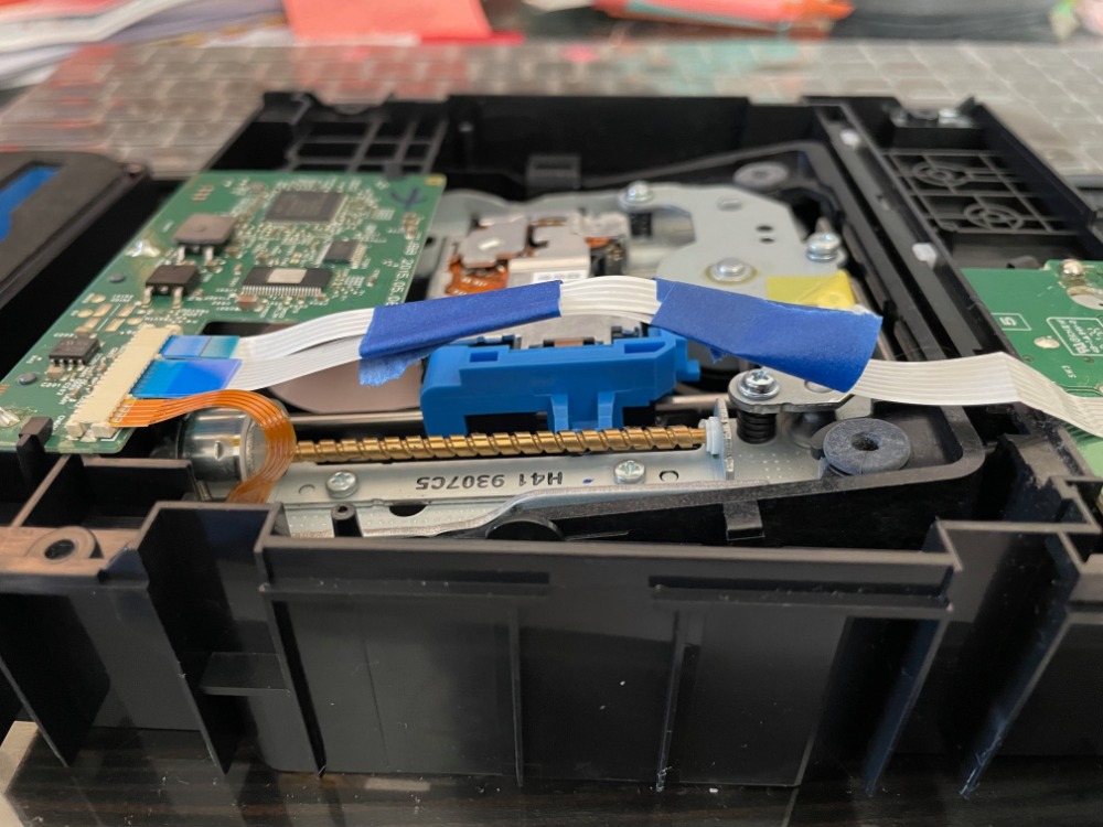

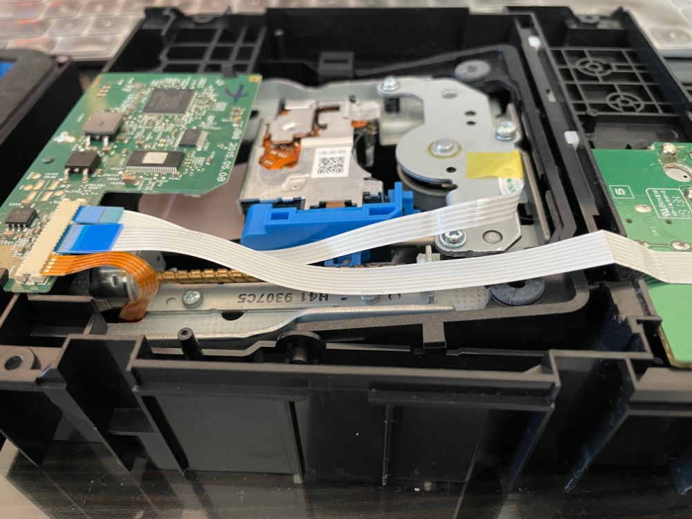

I just wanted to say thanks for this post. As shown in the before/after photos, I did a similar fix based on what you described. When the bottom plate is put back on the drive, it seems to do well keeping the cables off of the brass screw that moves the laser sled.
As an extra bonus, I placed some grease very lightly along the brass screw as well as on the plastic where the sled contacts the rails. I think it'll lube itself over time. I placed a dab of 90% isopropyl alcohol on the laser lenses to clean them but in these drives they are suspended on little wires so there's no scrubbing possible AT ALL. I guess that's the usefulness of cleaning discs, I'll have to get one.
No more grinding noise! When I initially opened the case, it was pretty easy to see how the ribbon cable would come into contact with the brass screw that runs the sled. It runs nice and quiet now, and fast.

Before:
After:
