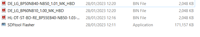

Hi. I have just got a bp55 slimline external usb drive. I have used the sdf tool flasher thing it is now on bp60 ffirmware and it now will load uhd blurays (which it didnt out of the box on 1.03 fw)
but i cant get it to open/decrypt the disk. i tried 2 different disks and this is what i get.

im new to flashing and not sure if i did something wrong these are the things i used.

Your issue is you can't write to F you changed it to a place you don't have permission to write or that does not exist or even more silly your trying to write to the drive itself

Thanks though another member beat you to it. that was the problem FYI this drive now works like a charm. way better than my old asus.
