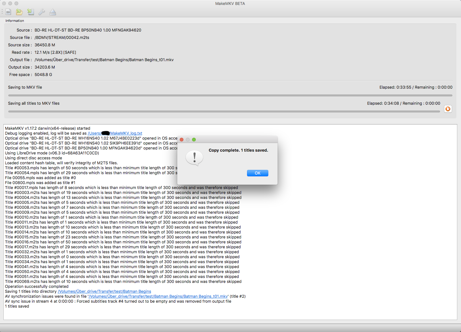

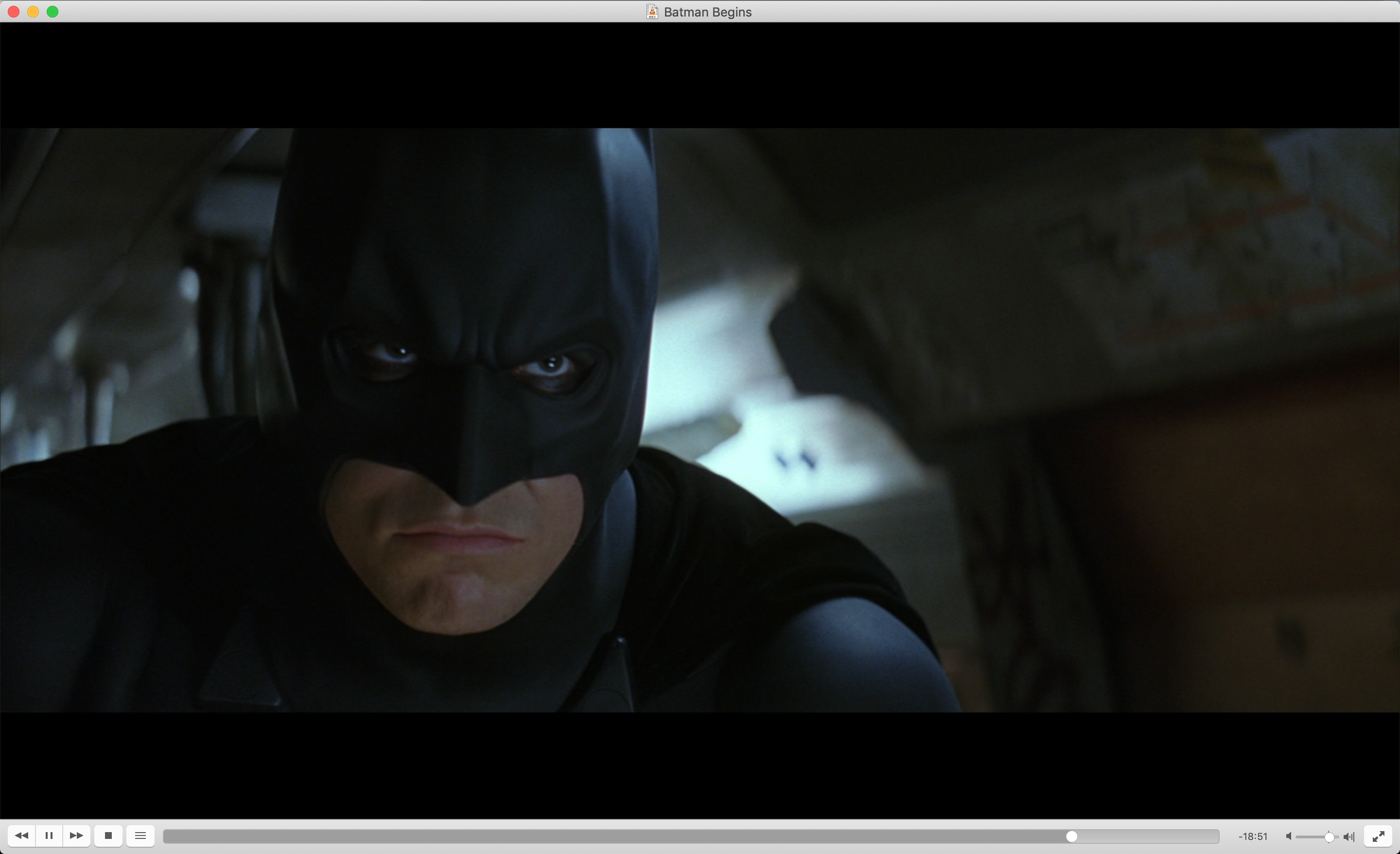

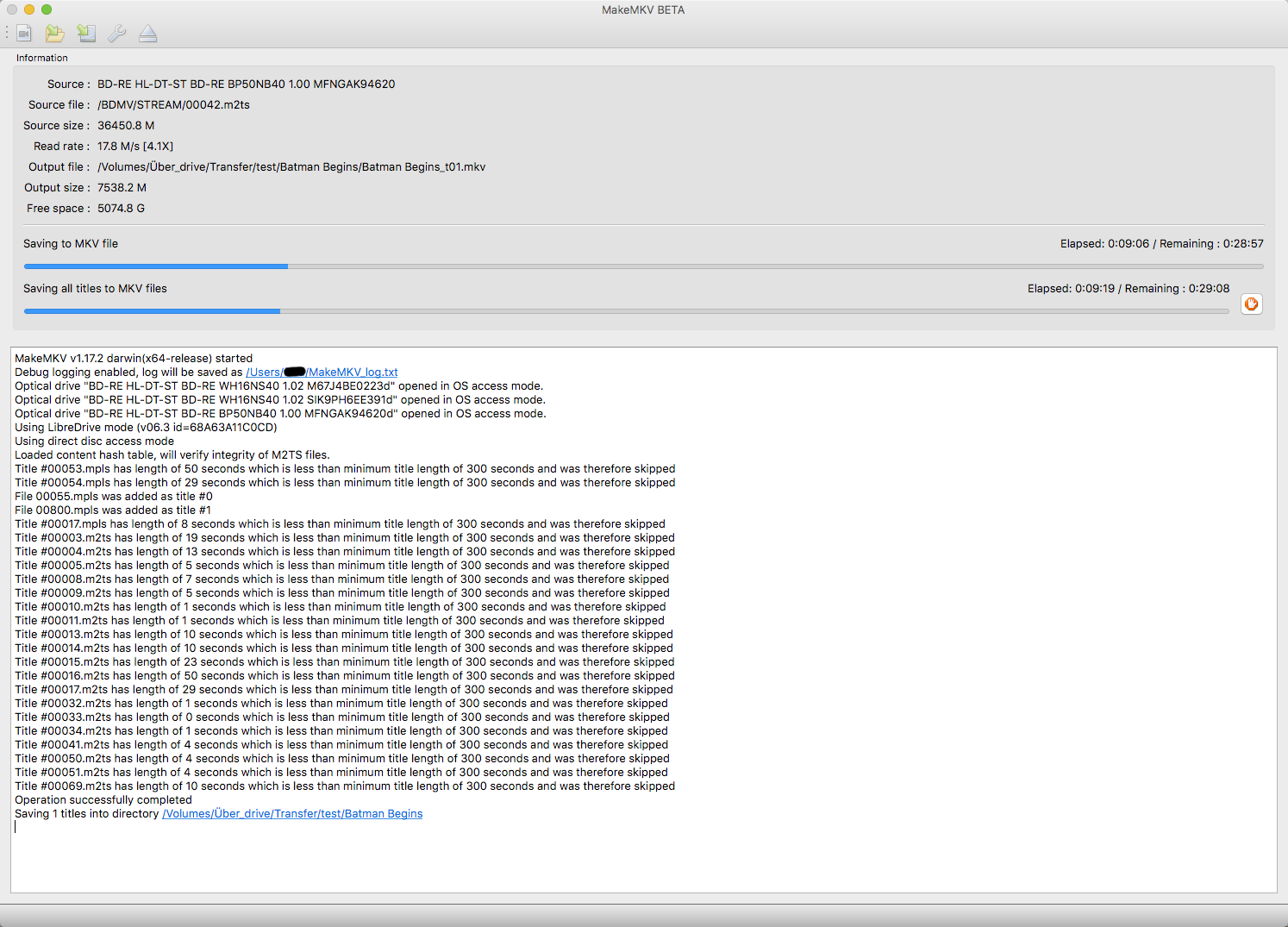

Post by scarpogre » Sun Dec 04, 2022 3:01 am
To test the drive, I ripped Batman Begins (BluRay) for a test and it is working OK.
Thanks again for the help
